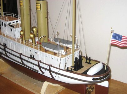

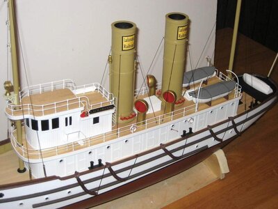

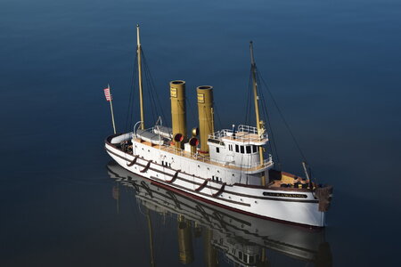

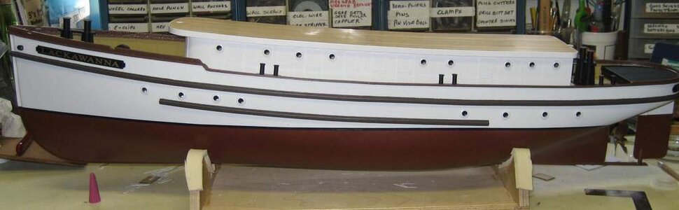

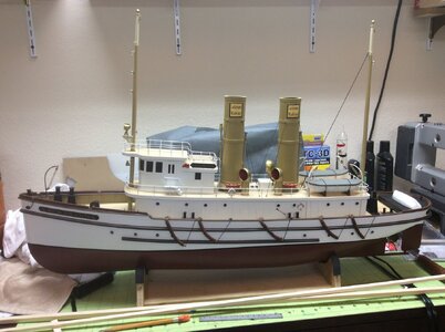

I have always liked this tug so when Dumas came out with their new kit I jumped on it. Sorry no actual construction photos really but here is what I have.

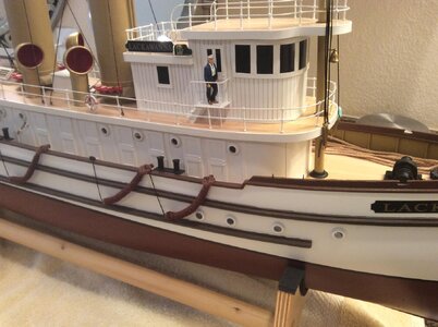

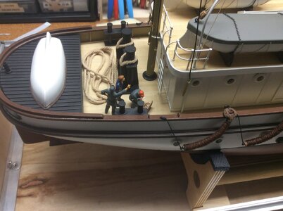

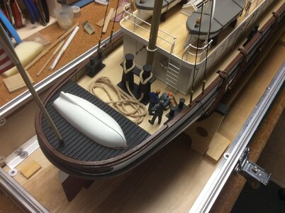

I added some figures to the model. There seems to be an issue with a broken ladder rung.

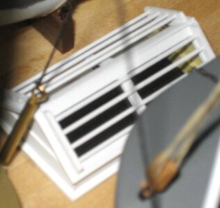

I had the Blue Jacket kit at the time so I added some details to the main cabin roof based on the BJ kit.

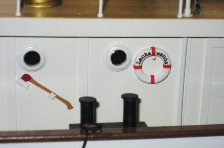

The First Mate did the letters for the life rings and the stack emblem. She mixed the color for the stacks and did the detail painting on the figures. I am very lucky to have had her as my building partner for the past 48 years. We work well together.

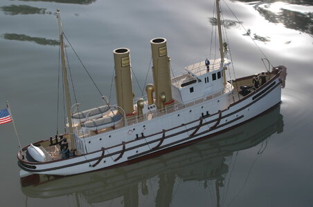

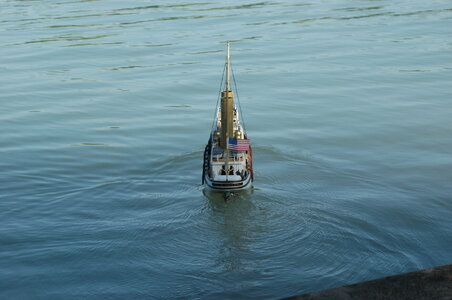

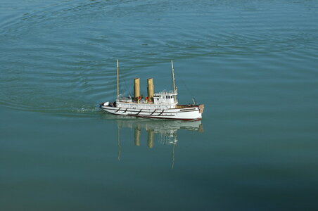

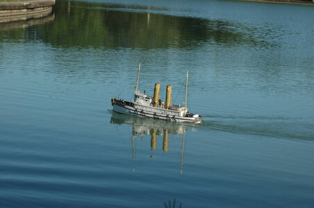

Very nice. I wish you had more pics of her on the water.

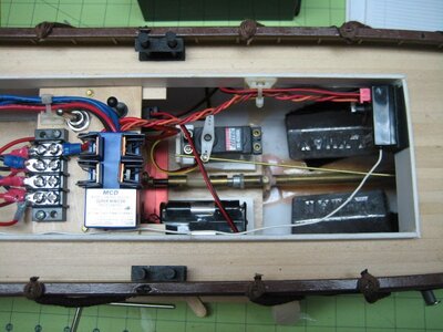

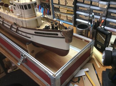

That's a lovely piece of work!! Congrats! I was thinking of building this model, but I have only done one previous RC model. I notice from one of your photos of the engine room that there is a lot going on. My previous RC model (Ulisses by Occre) was quite simple - one motor, one battery, servo. So, given my newbie experience with RC, I'm wondering if I can get away with something similar for the Lackawanna. Also, how do you remove the upper portion cabins to expose the mechanism? It looks like the mast and stays get in the way??
Again, a lovely job. It's a beautiful model!
Thank you, she looks good on the water. You can certainly do the boat with just rudder and speed control. That is just what I have working on my boat. It looks complex because it is older technology.
The cabin and both masts are a single piece. The cable stays are elastic cord. This is not the elastic you get at the fabric store. You can use the fabric store stuff but it won’t last over time. The turnbuckles are just hooked into eyelets on the deck and bulwarks.
The trick was getting the ballast in the right place. I used ingots with Velcro to keep them in place. The battery placement with depend on what you decide to use.

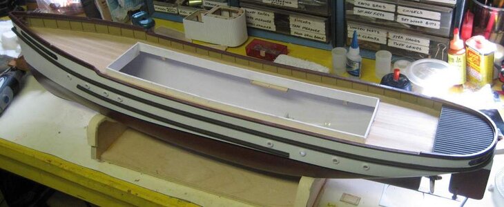

You should have no trouble building the kit. Focus on getting the the hull joined along the keel.

Sure, I will be the first to say that historically Dumas instructions were pretty bad. This changed fortunately a few years ago. The instructions for the kit were very good. There is always room for improvement but the only issue I had was with the rail bending pattern for the cabin roof. The kit I got had a hull half that was not molded properly. They replaced the kit no problem. The kit provided enough planks for the main deck but if you want to do more you gotta use you own planks.

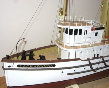

Very nice model and well photgraphed. How did you do the "pudding" on the front of the boat? Was it included in the kit?
I had to make the pudding because there was not anything included in the kit to make it. I made a small frame and covered it with very thin plywood. Then I just added the cording 1 piece at a time. Thank you for the kind words.
