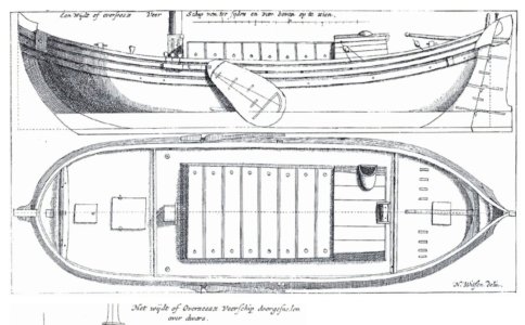

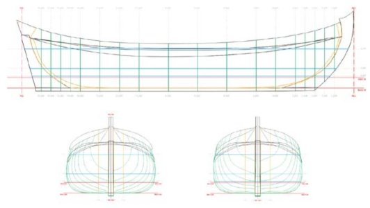

It is a construction of limited breadth to pass the channels inside the Seven Provinces avoiding the long journey of the blue water coast. So I took the plans and did work on a way to realise the upscaling from the original drawings in an A4 sheet in Ab's 1/77 scale to the 1/44 scale I do need for my bad eyesight.
Here I do deal with a 60DutchFeet/16,98m long freighter, a typical Dutch construction - a blunt bow and a interesting rigg. As I do stay with the Dutch scale system based on "One feet is eleven inch!" So my scale becomes 1/44 and the model will be 385,9mms in Lpp.

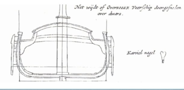

Ab Hoving shows the contemporary sources as N.Witsen and Dutch baroque painters. Due to this we do get an instruction how to build this model. I also looked for paintings and drawings of Smalschips for references.

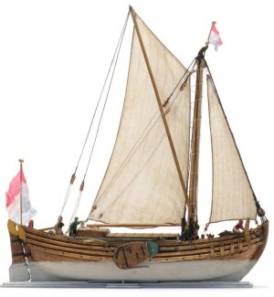

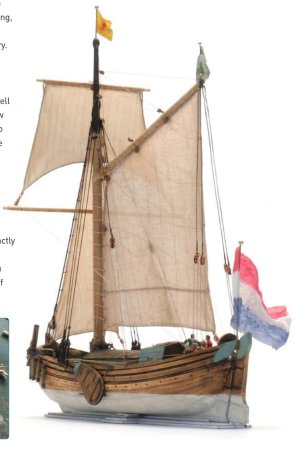

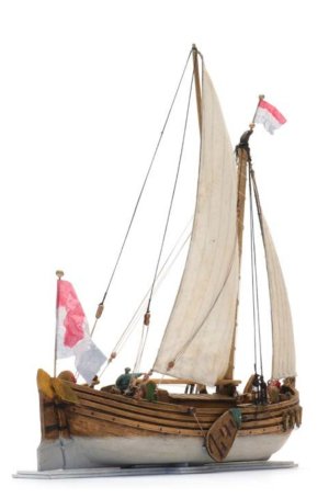

As you do mention it is the very same hull;
As atop this hull it is possible to place different riggs, so you do get several boats from the very same plan - this have the idea ton me to build a pair of them parallely. Perchance dealing with the length and topping of the main hatch and cabin to get a more distinguished result.

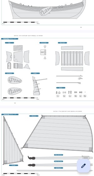

In Ab's book you do find 12 pages in DIN A4 for the plates with drawings in 1/77 and due to the scale gauge on every single plate, you can change the scale a you need up and down. The closest scale between Dutch and Imperial system would be 1/77 and 1/76, 1/66 and 1/64 so as 1/99 and 1/100.
