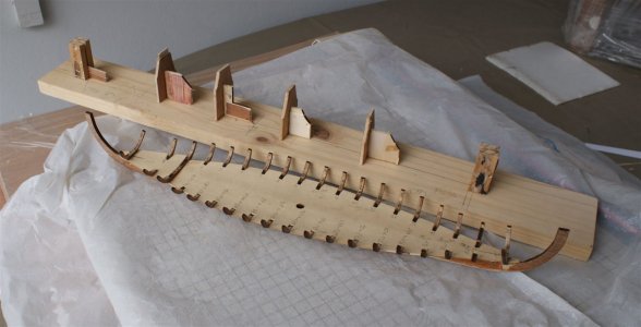

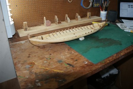

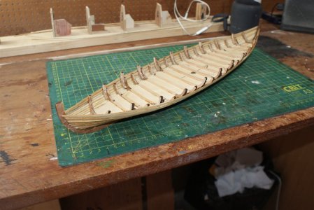

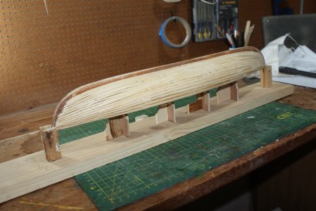

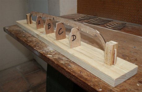

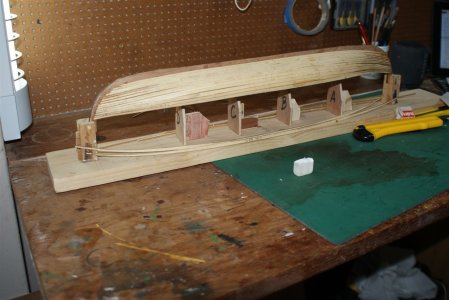

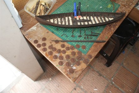

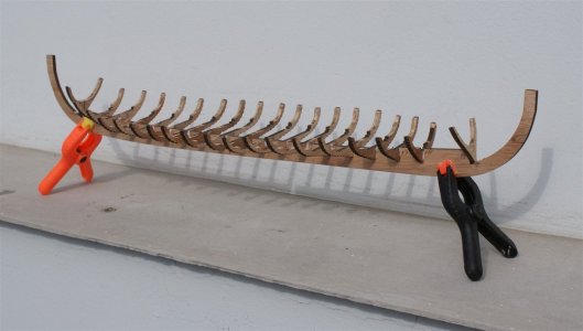

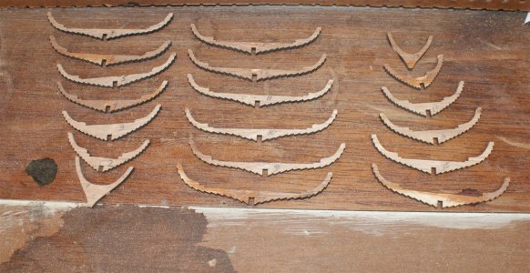

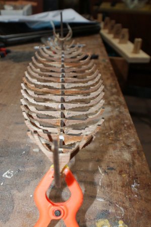

I developed the model based on some plans that I obtained from the internet. Like the other works, I redrew the keel, the frames and in this case the strakes in AutoCAD, which have unique shapes, each one differs from the other.

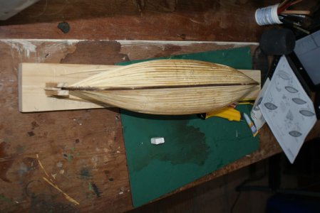

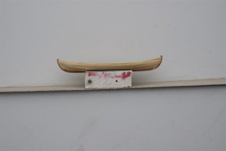

I had the keel and frame sections printed on 4 mm plywood, the strakes on 1.5 mm plywood. I thought it would be a simple model, but the entire alignment of the structure was out of square, and the strakes had to be made about 1.0 mm, because they did not curve well at the bow and stern. Tired, I abandoned this little boat for several months, until December when I restarted. I partly corrected the horrors, but they are there.

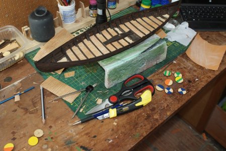

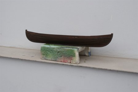

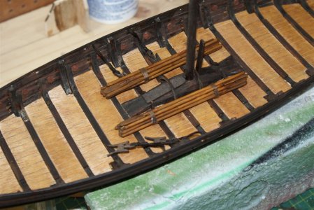

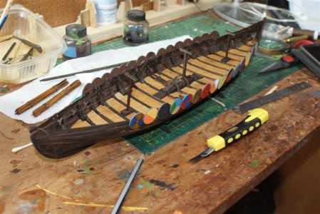

The hull, rigging and deck accessories were stained dark walnut, the deck was left natural wood color. The shields that are fixed to the gunwale were prepared. I made them in various designs and simple colors, because it is probable that the men belonged to different clans.
The base of the mast was assembled, the yard supports and the oars were made. Other deck elements such as the rowers' seats, merchandise, water barrel. The side rudder was also placed on the port side. In the making of the sail, a thin cotton cloth painted in black and red was used. I was not convinced by this model and it remained for months without a dragon's head or tail; In the end I assembled them to give the Langskip to my grandson, luckily the model is still intact
