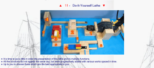

Here is an example of do-it-yourself lathe; i have build one for myself but i was not able to make it a "precise" machine.. Still using it for a rough shaping... (the picture is from shipmodeling.ca)
103544
.. but when build tasks are demanding more precise work, then i use a Proxxon mini lathe...

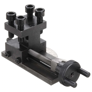

This is the rotary tools holder which could be obtained for less than 24-30 US$, with some DIY hacks it would turn that mini lathe into the serious modeler's tools..
Jul 11, 2018
80
143
I see this tool only moves cutter along one axis. We need two axes to get serious.
Yes you are right, there are available 2-axis tools holders that could be applied. Yet for simple work which I intend to do on this one - one axis is enough since I am going to make custom designed knives/ scrapers that would carve cannons or barrels or other items i a single pass just moving it perpendicular to the rotation axis.
Of course for any other work or using standard knives, 2 axes are required

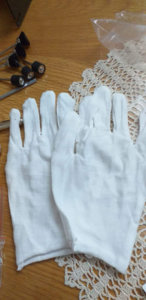

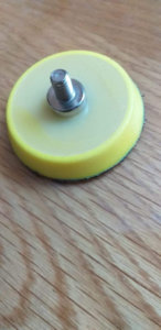

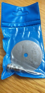

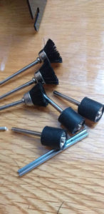

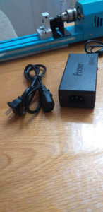

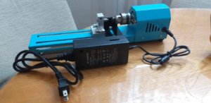

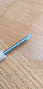

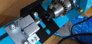

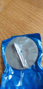

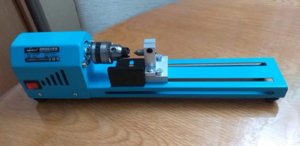

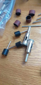

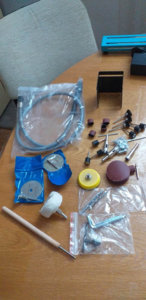

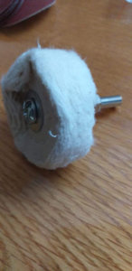

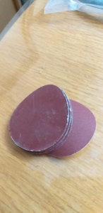

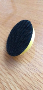

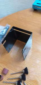

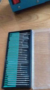

As I promised, I am posting pictures and review of the Chinese made mini wood lathe that I ordered through Aliexpress.
Shipped all from China to Serbia, free of charge within 20 days so to say- extremely fast. Everything received to the specifications and if you keep in mind the pricing of this complete, it is quite high quality and good price/performance ratio. At the first glance it looks really suitable for me to produce small wooden/ plastic parts for my models... one is for sure.. probably I would never more need to order cannons which I expect to make on this tools with the use of the custom shaped wood lathe tools easily, out of wood or even black plastic round rods. Barrels, cannons, deadeyes, carronades, winches, etc... could be easily done on this piece. I think that I could recommend it as a cheaper yet useful solution for some modeler's work .
Below are some pictures of the package items:
