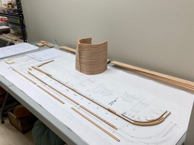

I started this one back in 2019 (mainly the axial timbers) and after a few year hiatus have started building frames as of the beginning of August - 20 so far (roughly 1/3rd of the total frames. I am using swiss pear almost exclusively. The frames are simply assembled at this point and stacked. They all have some extra "fat for final shaping and sanding.
So far I am finding the larger scale very user friendly for my first plank on frame build. The total length will be around 46 inches or so.

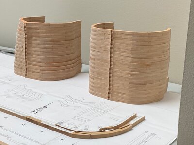

Thanks for the bday wishes ! I do have progress to report. The frames are all assembled and waiting for final sanding. The construction site is finished. And I bought a new mill - which will come in handy for the difficult stern parts up next. I have attached some photos including the keel section, where the Taig Mill came in handy for the notches and cutting the rabbet.
Better late than never, so happy birthday Birthday-Cake
Fantastic work:)Okay
