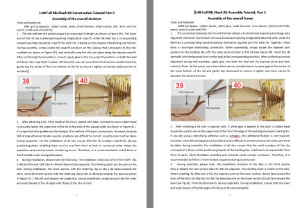

The following is the same section of the manual, with the Google translation on the left and the openl translation on the right. I prefer the openl translation but I have both available for reference.
