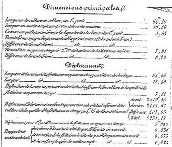

Hello! I have a question about ship model 1/40 in the museum. The ship drawing includes two options - theoretical (discussions principale) and actual (déplacement). So the 1/40 scale model of the ship was built from a theoretical drawing or an actual one? Somebody knows?

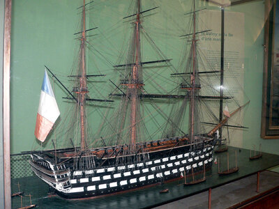

Do you mean the model in the museum in Brest?
As known the Valmy was laid down at Brest in 1838 as Formidable and launched in 1847.

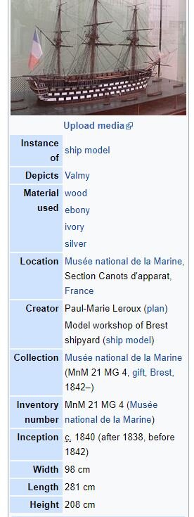

and these information are given about the model:
photos of the model:
For me it seems, that the ship model was build very early, when the ship was still in the yard under construction. Here the information is given that the model was finished appr. 1840, definitely before 1842!!! At this time the modelers needed also one or two years for such a model, so therefore I guess the models was build based on theoretical (discussions principale)
