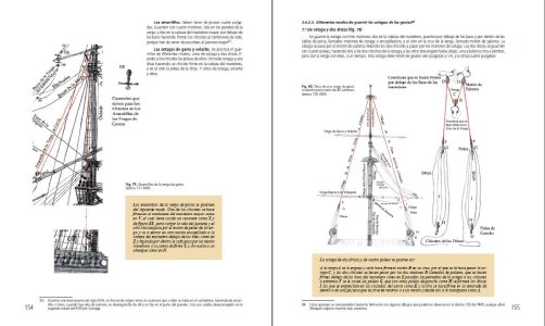

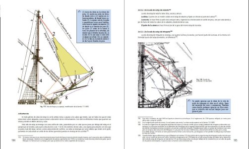

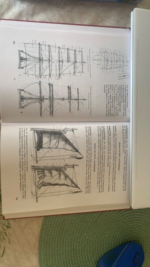

My textbooks, as a general matter, state leach lines run from the side up the front of the sail to a block stropped to the yard then (on the primary courses) to one or more blocks at the top and down the back. For a topsail, the line could run in front directly to blocks stropped to the tye (dependent whether the yard is static) and down the back but otherwise would run to the yard then mast head and change there.
My Occre Diana kit shows the Leach Line running to the yard block then down. This is not exactly a clean pull. In practice it would definitely cause some chafing. The written instructions do not indicate if the line is entirely on the back or on the front and the back (the line drawn is all solid). There are photographic instructions both ways. I have emailed Occre, but does anyone know of any historical basis for their type of leach line rigging? They use this method consistently on the Romera de Landa-designed frigates and Ships of the Line kit instructions.
Also, I am seeing some source disparity in the number of bunt lines on the primary courses. Zu Mondfeld says one pair for small ships and two for large during my time period -- does one pair mean a total of 2 per sail or 2 per side of the sail so 4? Steel's chart for a 28-32 gun ship shows 4. The same vintage Occre instructions tend to show one line per sail side. Does anyone have any good sources on this besides Zu Mondfeld and Marquardt? I am ignoring Peterson because he shows an English ship.
Thanks for any help or logic!
Thanks in advanced!

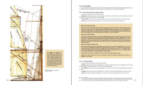

The best sources for the rigging of 18th century Spanish ships are probably:
– Juan José Navarro, Álbum del Marqués de la Victoria 1719-1756, Lunwerg Editores, Museo Naval Madrid 1995, ISBN 84-7782-352-9
– Isidro Rivera (ed.), Arboladura y jarcia española de la segunda mitad del siglo XVIII. Compendio Compuesto por: Cartilla Marítima, Santiago Zuloaga 1760 & 1766. Tratado instructivo y práctico de maniobras navales, Santiago Zuloaga 1766 & Reeditada 1806. Reglamento de Jarcia, Marqués González de Castejón 1773, Associació d'Amics del Museu Marítim de Barcelona, Barcelona 2010, B-42878-2010
Modelos de Arsenal del Museo Naval. Evolucíon de la construccíon naval española, siglos XVII-XVIII, Lunwerg Editores, Barcelona-Madrid 2004, ISBN 84-7782-959-4
Try to locate them yourself at your place first, as snooping through these items is a bigger job.

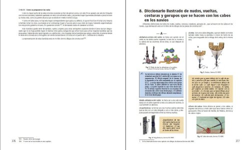

Great answer ... but there are a few hiccups going from theory to execution ($$$$$).
>>>>>> Euro 832 = $892 I can't justify spending this much money especially since my ship is in the last quarter of the century and rigging would probably have evolved.
>>>>>This is the holy grail and I have been looking for it quite a while, hoping to get a new print for the official price of 40 Euros. First edition out of print, used copies from Euro 190 = $204. You would think they would shift to print on demand! Do you have any idea where it can be obtained for cheaper? PDF is best so I can use machine translation!

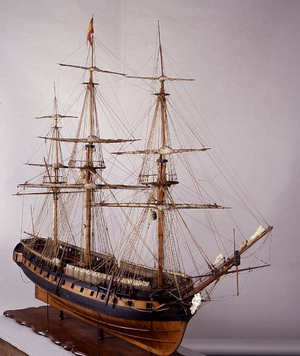

->>>>>>>Got it. Excellent book but very few models show sails (which is normal), even fewer unfurled. The best model has obviously new sails and one needs to question the integrity of non-contemporaneous models. No way for me to confidently to figure leach lines and bunt lines from this book.

Look for the keywords "Brioles" and "Apagapenoles". In the tables in the Reglamento de Jarcia by Marqués González de Castejón 1773, you will find the quality, number, length and circumference of these ropes for all the sails of the most important ship categories.

I have been translating various sections of:
-Cartilla Marítima, Santiago Zuloaga 1760 & 1766, from page 150 there is the "Reglamento de Jarcia" del Marqués González de Castejón 1773:
and run into three problems. The first is that some of the words are outdated, fixed by guessing the close modern equivalents. The second is that some of the nautical terms have either no translation even in tureng.com or multiple translations (e.g., contrafoque is both fore topmast staysail and inner jib (i.e., regular jib)). The third is that even the google version, which is the cleanest version I have seen, has so many imperfections most sentences need manual clean-up. It is a real slog. That plus it refers to a two-decker whereas I am working on a frigate decked ship.
Does anyone know if an English translation has been done? I have not found it online so I am more referring to the community. Thanks!

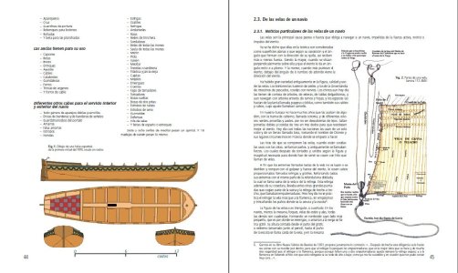

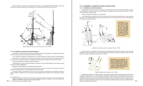

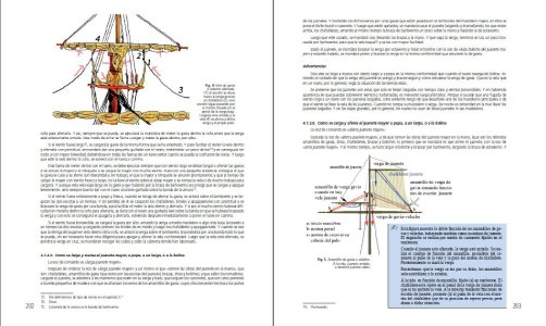

Hello, allow me to contribute something to this conversation. My name is Isidro Rivera, and I am the author of some of the books cited.
Unfortunately, practically all documentation about the Spanish Royal Navy is in Spanish. I myself only speak that language; fortunately, we have Google Translate ;-)
Certainly, the book on masts and rigging mentioned is out of print, although the cultural association of which I am a member offers new editions.
We have currently published a book on rigging and rigging from the first half of the 18th century, full of 18th-century drawings. Unfortunately, it is almost out of print and we only distribute it in Spain.
