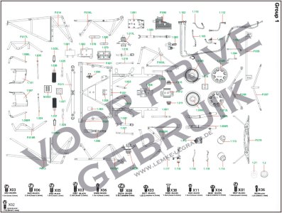

The first two pages provide an overview of all the parts and bolts required for building Group 1:
Source: the link on the Lemke-LeGrand website, but also via the QR code shown later in the manual.

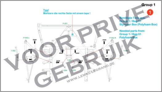

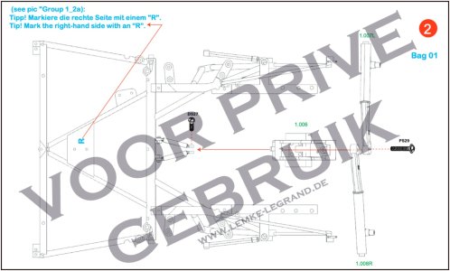

Group 1, step 1:

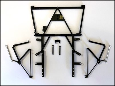

Also collected the parts for this review:
Group 1, step 2:

P.S.: Here, the parts are upside down, the parts marked 'R' and 'L' can be confusing.

Some parts are mirror-image identical. You could interchange them. However, the parts have small 'L' and 'R' markings:

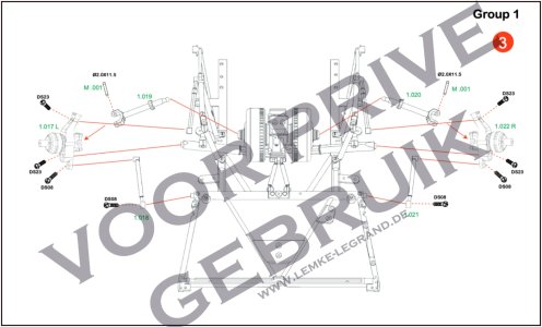

Group 1, step 3-1:

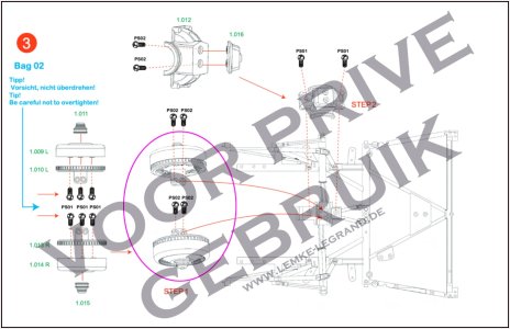

Two interesting parts right away: the drum brakes.
Here's a look at the previous photo, with the front brakes circled:
Rodolf Uhlenhout opted for large drum brakes because he wasn't entirely confident yet with the recently invented disc brakes.
Specs: inboard duplex drum drakes with power assist, Front: 350mm (13.8 in), Rear: 275mm (10.8 in).
Because he wanted to keep the unsprung weight as low as possible, he placed the drums on the inner fixed parts of the axles. This allowed him to install larger brakes that otherwise wouldn't fit within the wheels.
