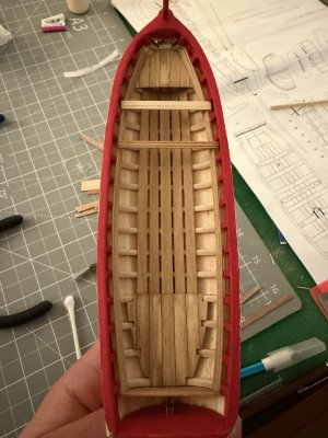

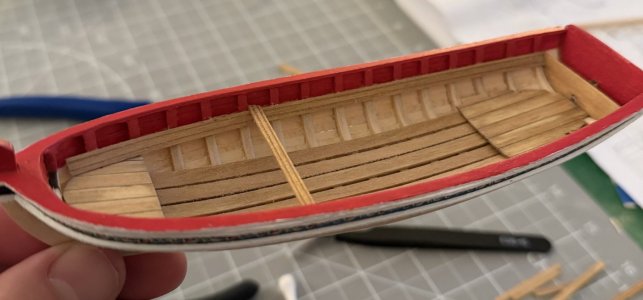

Hello all! New to the forum, but I thought I would share the current state of my longboat (and ask a question that's been bugging me while I'm at it). I've been working on this for about a month, usually after the kiddos go to bed. It's not the neatest (and I may have strayed from the instructions in a spot or two), but I'm pretty pleased with myself! Next step is to install the thwarts.
My question is regarding those thwarts. The instructions call for me to use 1/8" strips, but I think they look a little small. Also, the pictures I see in the kit (and build logs) show little cutouts in the thwarts so they hug the frames/ribs. Since my frames are about 1/8" wide, I don't see how I could do that. Maybe I was supposed to sand those down when I fared the interior? Regardless, if this is a 0.25" scale model, wouldn't that make these seats only 6" wide at full scale? Seems too narrow for a rower's seat, but I'm new to the hobby and certainly not a historian. Does anyone know if that's an accurate representation of a thwart on a longboat, or is this an artistic choice of the designer? Alternatively (and most likely) maybe I'm misinterpreting something?
I'm tempted to swap in 3/16" planks instead (shown in the pic for reference unstained), or join two 1/8" planks together, but I'll happily bow to historical accuracy. Thanks for your help, and let me know if you have any questions!
I like the wider planks better. I would not like to try rowing the boat sitting on a 6” wide seat.
Incidentally most of the thwarts in a longboat were removable in order to stow bulky cargo, especially large water barrels. Three were not; the one in the bow, the one supporting the mast and the one just forward of the stern sheets. These three permanent thwarts would have been reinforced with knees tied to the frames.
Roger
I like the wider version, and one has to remember two points in building old ship and boats.
First is plans are not always accurate, and ships Captains often change things to fit there personal whims.
Second, is that this is your model boat, and build to what makes you happy, as I don't think you will be displaying in a museum where folks will want to check it for accuracy.

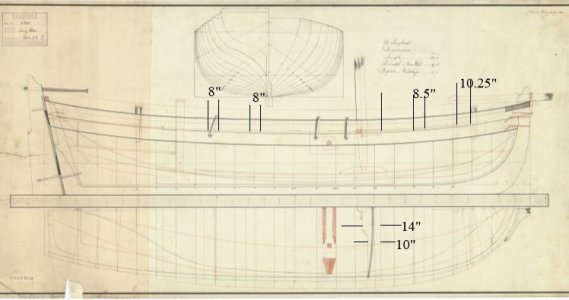

Another way to find dimensions. The drawing below is available on the Wiki Commons site in high resolution and in low res on the RMG Collections site. You can use these contemporary drawings as a source of dimensions as well.
31 foot longboat with some of the thwart breadths that I measured and noted as examples.
This is such an incredible trove of information - thank you all so much! This solidifies my thinking of going with the thicker thwarts. By my calculations, that would make them about 7.5" wide in 1:1 scale - close enough for me. I think it looks better, and being a bit more accurate makes me happy. I joined a 1/8" scrap to make the mast-supporting thwart slightly bigger (13.5" in 1:1 scale).

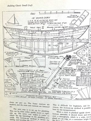

That boat is looking nice, especially considering how small the model is. Regarding the notches in the thwarts to secure them at the frames, I have attached plans that show that feature for a different type of traditional boat that also has removable thwarts: a banks dory. This plan is from Building Classic Small Craft by John Gardner. You can see how the thwarts are notched over the frames. In the case of this dory, the thwarts are specified as 7/8" X 9" white pine. The frames are of 1" oak. So the notches work fine. If I was to guess, I would guess that your ribs are sided too large for scale. So you will have to forgo the notches. That sort of thing is difficult to do correctly at small scales. Fair winds!

For anyone curious, I took a stab at the thicker thwarts - here they are stained & dry-fit. I also played around by adding tree nails. From my (very brief) research, it seems this might not be wholly accurate, and the color is way off. But, since so much space is being taken up with thicker thwarts, I thought this would give a little more visual interest/depth within the model. Was fun to play around with anyway!

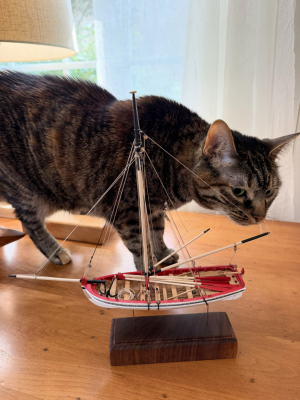

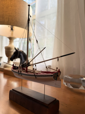

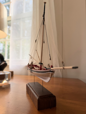

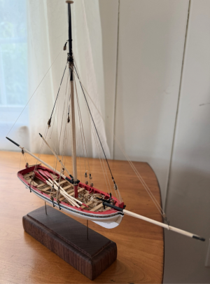

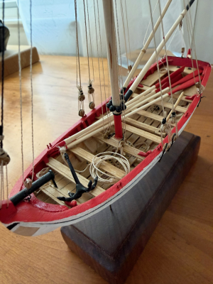

I finished the boat over the weekend! Here are a few pictures of it completed and on a stand I whipped up (cat for scale). Have to say, I learned A LOT during this build. It was a blast and, even though there are certainly some things I'd do differently, I'm quite happy with how it turned out.
Specifically regarding the thwarts - I went with the wider ones, but I think I understand why the kit calls for them to be so thin. They take up quite a bit of space, so installing things like the anchor and some rope coils were a challenge (and still look crowded). Still glad I did it the way I did, because it helped me digest scale in a way I'd miss if I simply followed the instructions.
My next project is going to be the HMS Racehorse bomb ketch/arctic explorer. I'll probably do a build log for that one in case anyone's interested in seeing my (many) mistakes!
Thanks again to everyone for your kind words, assistance, and resources! Please don't hesitate if you have any questions about how I approached this build, and I'm always open to feedback!
