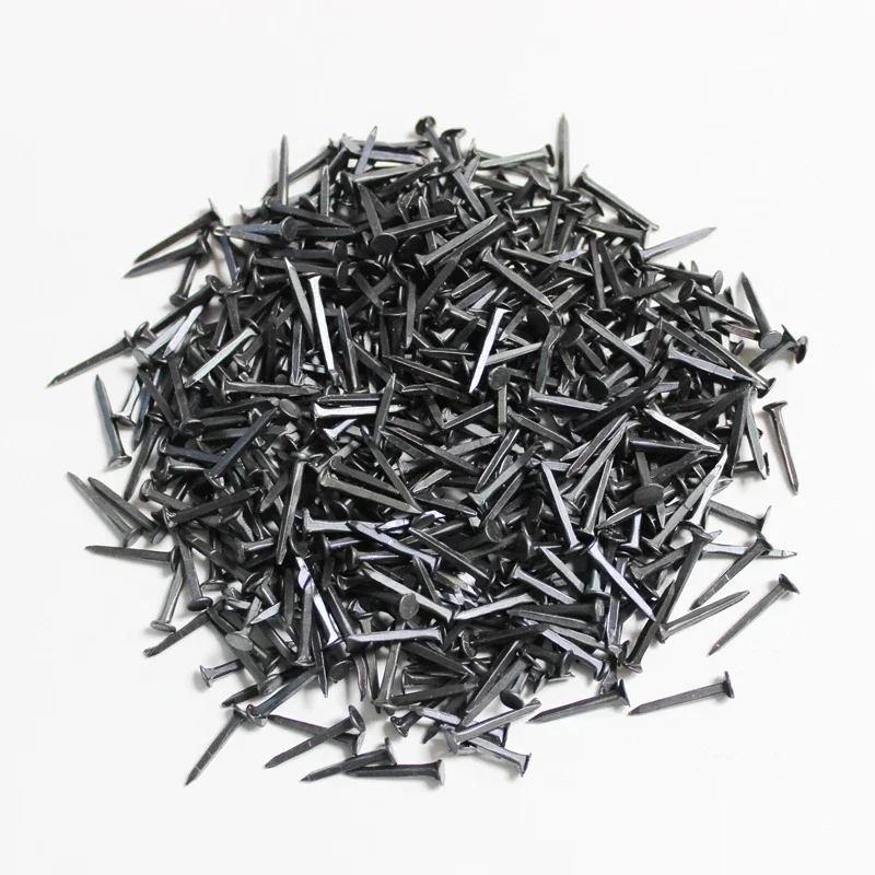

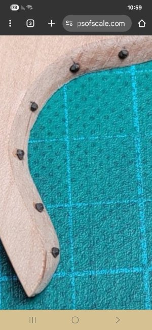

Hello my dear friends
I am asking for your help in locating an online store where you can purchase tiny nails with a round head along with a square or pentagonal end.
I am not looking for a round head alone or a square or pentagonal head alone, but a head that combines both shapes together.

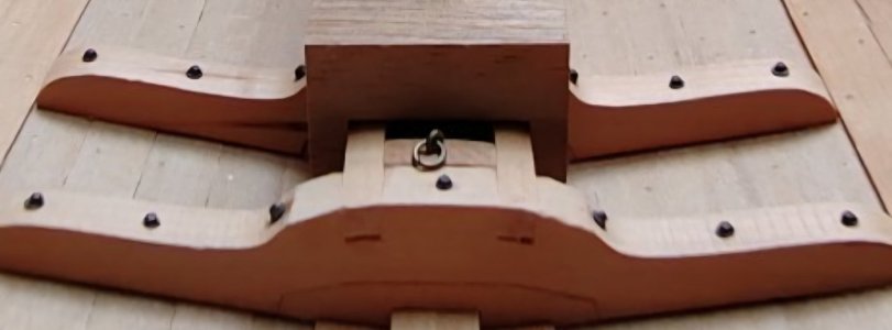

Screenshot_20251013_105902_Chrome.jpgScreenshot_20251013_110043_Chrome.jpgScreenshot_20251013_105902_Chrome.jpgScreenshot_20251013_110043_Chrome.jpgI am attaching a picture of the model that our friend Marslav is building for illustration.

View attachment 549999View attachment 550000View attachment 549999View attachment 550000I am attaching a picture of the model that our friend Marslav is building for illustration.

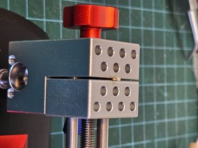

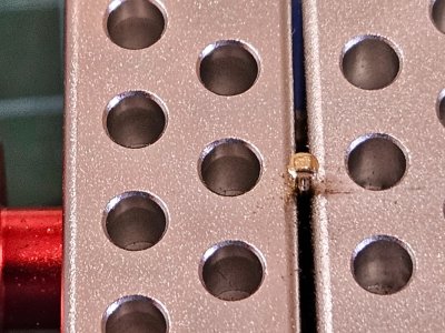

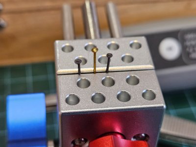

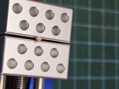

This is the result of my own work, I will try to improve the result by manual milling using a Proxon MF70.20251013_115802.jpg20251013_115837.jpg20251013_115856.jpg
In square nails, to avoid making too large a hole in the wood, you'll have to round off the bottom with a file. Fortunately, there aren't many nails on the ship, so this type of work is fine. Maybe someone else has some ideas.
Hello Shoto. I use the same bolts as marsalv, purchased here at a Czech rail shop.:)
Other brass material is great too! Thumbs-Up

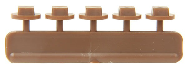

While your description confused me, what you show appears to me to look like a bolt with a square head and larger washer. If that is the case, these are available in multiple sizes in plastic from model stores and are mostly used for 1/35 scale armor (tanks) and railroad models. They wouldn't be metal, of course, so would need painting, but might give you what you want. Meng makes just the heads with or without washers, and are applied to the surface, while Tichy Train Group makes short bolts to be inserted into holes. There's a great variety of these in style and size, so something might work for you. This is basically what I was thinking in this case:
www.hobbylinc.com carries these particular ones.
Hope this helps.
