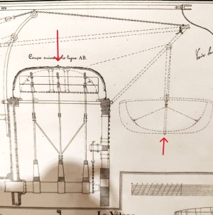

L'Orenoque Mamoli 1:100 scale
your musings on the sponson fittings brought me to look twice at the cross section of the sponson
which made me realise that the main axle is directly under the deck... So where is the space for the crank ? This made me realise that the two structures that i had taken solely for ventilators on both the Sphinx and under the bridge of l'Aigle are actually essential... as crank housings, one for each piston of the engine.

Martin! Chapeux! I'm almost certain that I would have missed the issue of the crank houses. It just dawned on me that I should be concerned enough about other machinery, boilers come to mind, so that I study and think before committing.

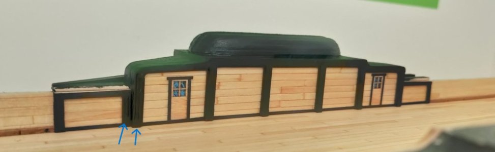

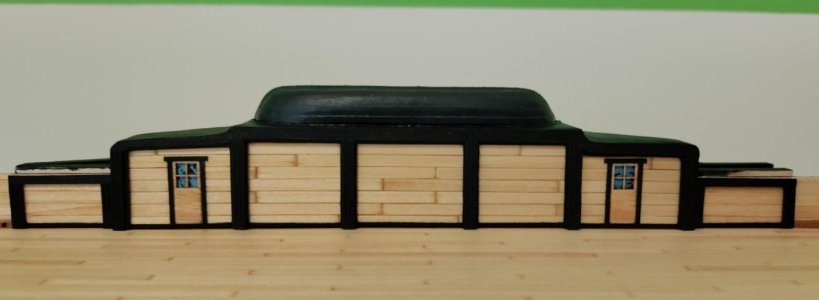

Surprise! I did NOT complete both inboard sponson fascades and work on the bridge by lights-out on Sunday ROTF The starboard side is done (save the hunges and handles for the doors) and the port side is almost done. The bridge is next and it will not be an overly complicated affair. I also need to think about things that would be attached to the inboard sponson fascades. You know, life-rings, life-jackets, etc.
A few poor quality pics. First pic - the short panels to either side of the fascade are individual pieces (red arrows). Their tops are not finished because they will be covered by the caprail after I permanently install the sponsons (green arrows). Second pic, I put some effort in fluting the columns which you can only see on these twoROTF In person, the fluting is almost invisible, but again, worth it.:cool: (blue arrows).

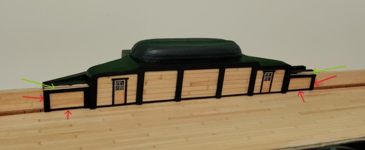

What ho, shipmates!

The fluting is visible in the second pic. (Blue arrows.) Very nice touch!

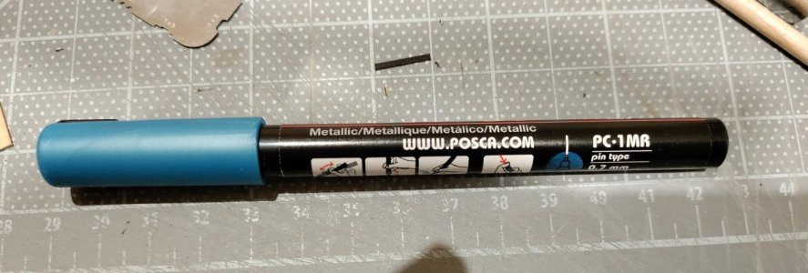

the glass in the doors looks good, how did you do that effect ? I am sure the fluting will show up more as the paint weathers a little , it's matt black ?
Martin! Thank you! The paint is Model Shipways "Hull Spar Black." It is a semi-matte towards the matte side. For the windows I paint the window area black and scribble blue metalic paint pen over it. Here's the pen:
