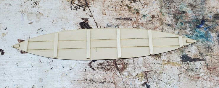

Made some progress today. Only had to glue each piece in twice! The big difference between this type of modeling and tanks/planes is you have to learn what each piece is called. I now know what a transom, stern knee, and stern cleat are. I guess that is part of the learning process.dory 3.jpg

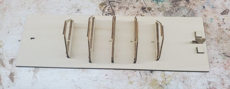

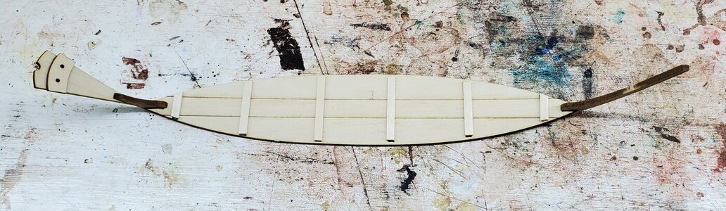

Here is an update on my progress. Added the braces then glued in the bottom. I had to shim up the braces to get them to be square. I used a piece of paper folded over on one side.

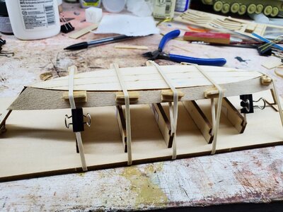

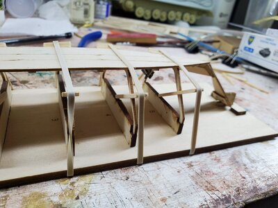

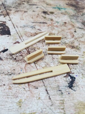

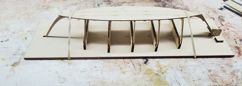

After a bunch of sanding I glued in the first plank. I had to make some brace blocks to get the rubber bands to press equally on the plank. I also made an adapter for the other side to make the band tighter.

Your rubber band tensioning jig is creative. Good idea with the added outriggers. I have been using various wood blocks and large erasers, (not for dories but planking where clips don't work.. Rich (PT-2)

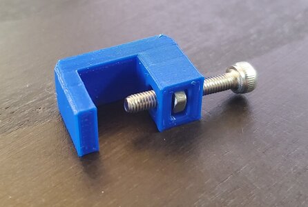

I like the eraser idea. The problem is the black clips are to strong to use in some cases. What would be nice is a bunch of small "C" clamps. That way you could adjust the tension. I wonder if they could be 3D printed with small m3 screws. Has anyone tried that?
I found this on thingaverse and modified it to use an M3 screw and nut. I think it needs to be modified a bit more to make the left side a bit thinner, so it will fit into small openings, but it looks like it should work.
