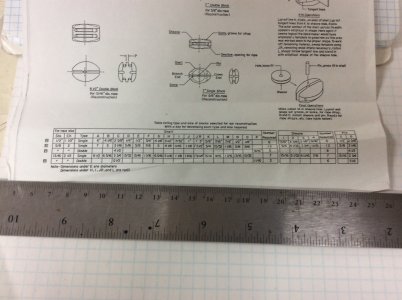

Hi everybody,
I am wondering what modellers do to craft the different types of Blocks and Sheaves for their models, built at 1:48 scale?
I would guess most folks that want working sheaves make their own blocks in pieces same as an actual block with tail piece, crown, etc. They look great on the largest blocks but maybe not worth the effort on smaller blocks as the line running through the block obscures most of the view of the sheave in most cases.

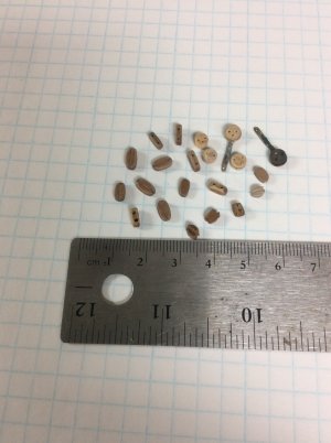

The dead eyes, I can make, but the single blocks are tiny, on a block only 73 thou wide, not achievable with the sheave, nor the double sheave block either, so I will make a mock-up and try to make them as real as I can.
