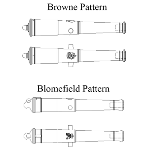

If you go with the Victory kit, you might find a set of scantlings beneficial as well as comparing parts with other sources based on contemporary information. For example, many kits use totally incorrect cannon patterns and sizes. Sovereign had Browne pattern cannon (issued circa1625-1649) and Victory had Blomefield pattern cannon (and Carronades) after her total rebuild in 1803. Drawings are below. I am curious to know what your model scales are and the cannon lengths and patterns to see how they compare to what was actually on the ships. If the patterns in the kits are incorrect and this is bothersome to you, I would be happy to email you STL drawings which can be used to have 3D printed cannon made in virtually any caliber along with contact information for a printer fellow that does fantastic work for very low prices.
