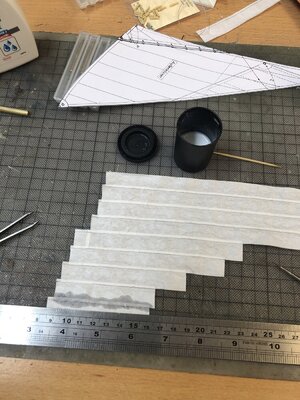

After some considerarion I decided to make it like the real sailmakers, in lanes.
The markings are recorded on the double-layered clothes, where they are laid on top of each other an glued together with a glue-water mixture.

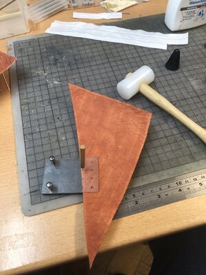

The contours of the sails are cut out using a template, with duplications on all sides and reinforcements at the end. Then painted with airbrush. Be careful, the sails are vey sensitive when they are wet. When dry, they are very stable.
After painting the sails they get a bolt-rope and the necessary holes are punched with punch and die set.
