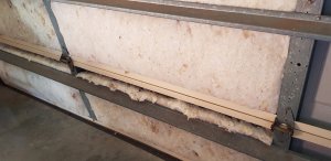

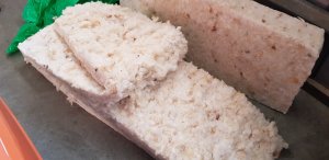

As most of you may know, last October my wife and I moved into our new home, which had 3 garages. It was one of the selling point to buy this house for me.
But I wasn't talking into the account that the 3 metal panel lift garage doors are in the direct sun light in the afternoon.
the sun starting to heat up the door about 11.30am and by 1pm the whole garage doors are in the direct light.
Behind the single garage on the right is my working zone. I am very pleased to have a large area as my 'playground'.
While the inside gets hotter and hotter.
So after 1pm the sun turns the garage doors into a sweat box with the doors acting as a heater.
Even though I got insulation, a R4.6 wool polyester blend in the ceiling, the garage in the afternoon could reach 45°C plus. It's too hot to do any work and unfortunately that's is the majority of the time I'm allowed to my build. My wife would like some work around the house done, first before any playtime.

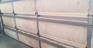

I had an idea that is what this post is about. I had one bundle of bats in the garden shed, so today.
I spit each bat down to make two.

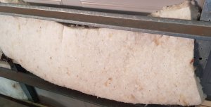

I placed the thinner bats in the grove sections of each panels.
Squeezing the bats under the framework of the garage doors
The result is quite good to look at, but the temperature in the garage now is a pleasant 23°C.
The garage door open with ease and the extra weight wasn't a problem.
The reason why this log is posted on SOS, I would assume there are other members who were in the same situation, and they might get some idea to fix their work area.
Havagooday and happymodeling to all

It rained last night!
G'day all
I have run into a huge stag.
Yesterday the panel doors open just fine and there wasn't any extra drag on the lift motor.
But
This morning when I tried to open the door, it jerked and stopped like it hit something. I looked about and there wasn't anything so I closed the door and tried to open it again.
Bummer
It stopped at the same spot. I tried it s third time, but I gave it a very slight help with one finger and it was ok.
I was running late for a doctor's a appointment and I told my wife I'll look at it when we came home.
We were out for about 5 hours and when we got home it was hot and sunny on the garage door.
It worked with no problems. I thought about it and I came to the concudion the bats must have absorb the moisture from the air, so the door was under more stain.
I didn't want to burn out the motor, so I removed the bats from the door.
I know my system was on the correct track, but I need something else that is cheap, light and wouldn't absorb moisture.
I'm still thinking.
Dame it!
Havagooday
Greg

Try it with some boards of extruded polystyrene foam.
It is light and isolate better.....and it is not absorbing humidity....

Thanks Uwe
I was thinking about it, but the cost is a little more than I would like. I havta look for some cheap supplies if I can find it.

We moved into a Villa earlier this year and some of the residents in our resort have added styrofoam panels to their opaque acrylic roller doors. Now the manufacturer is telling us they won't honour our warranty unless we pay them a service fee to come and increase the spring tension to protect the motor.
So it is do-able but you need to be careful.
