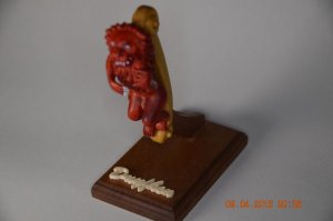

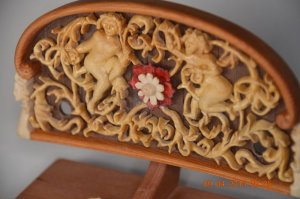

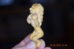

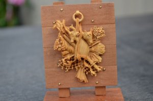

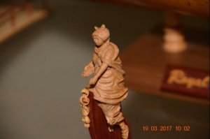

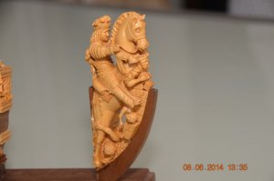

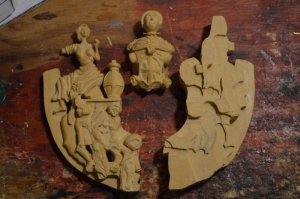

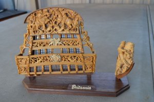

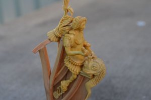

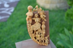

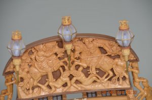

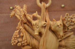

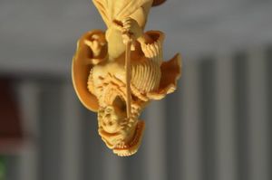

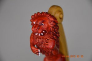

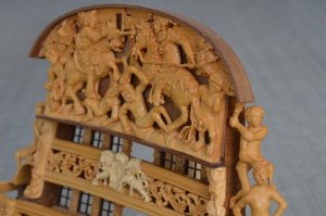

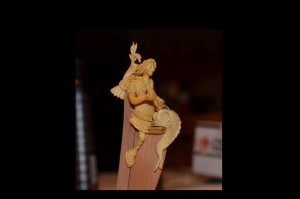

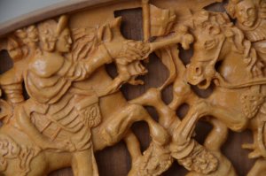

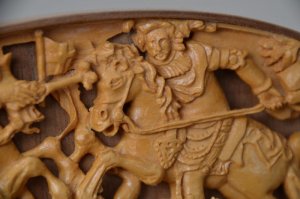

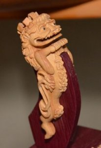

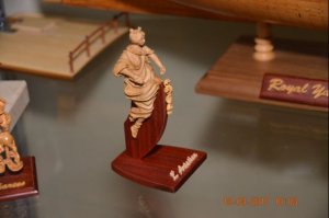

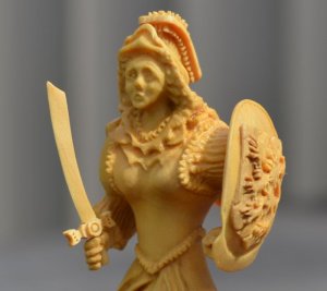

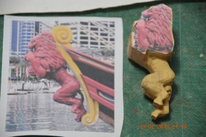

A few of my carvings. Material is European Boxwood, mostly left in its original colour. Only the Duyfken FH is stained and the Royal Caroline FH is gold leafed (trial piece for leafing, probably the last one of that). I am using a Micromotor - a special name for a rotary tool with wide rpm range, low revs and high torque. And also some knife blade and chisels as well. For finishing sanding and mostly scraping is used.

Thanks! I am using mostly rotary tools, a micromotor with different size and shape burrs as well as with diamond bits. Then I am sanding and scraping the carvings and apply satin wipe-on poly. The material is Boxwood (in most cases European Boxwood, but sometimes Costelo).
At the moment I am working on HMS St. Michaels' figure head as a by-project when I just have enough of Sovereign momentarily.
