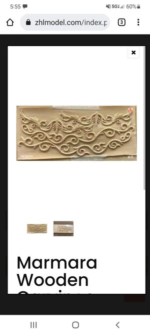

Hello D................. searching for a little help regarding for and aft HULL filigree decorations. I have four in etched brass and four in very fine wood. Do you choose one
over the other or is the wood to be glued to the brass then applied to the hull together.

You choose one. I used the wood filigree. The thin wood background needs to be taken by sanding.
Tape a big chunk of 320 sanding paper to a piece of wood. You place the filigree over it and with a sponge over the filigree you sand the full piece. Or any soft material able of moving the full filigree decoration over the sanding paper carefully as a block.

I refer to the thin wood seen here in the background of the filigree. Don't try to cut it !!!!!
Thanks Dan, that clears that up . Does the wood filigree conform to the hull without snapping or did you dampen first ?

JB, Is very thin and flexible. It just take the contour without any issue. Just be careful when managing it, "but not be scare". Thin, but strong also.

As soon as you place a thin layer of wood glue, that makes it more flexible and will stick to the hull very strong. No needs of any clamps at all.
