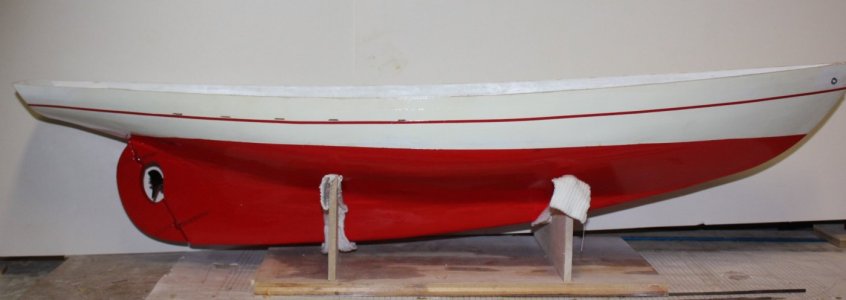

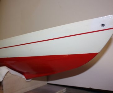

No matter the brand you use, there is the potential for bleed through under the edge. Unless the surface is as smooth as glass, literally, any imperfection will create a chance for bleeding under the tape. Narrow tape is better for following a sheer line then the balance can be covered with wider tape. Once it is all taped up, apply a clear coat with spray or brush to seal the edge. Once dry, paint with brush or spray. The clear will help prevent bleeding of the paint under the tape. Learned the hard way......
If I have to make a very narrow stripe, pinstriping tape is a great choice instead of paint. The pics below shows both.

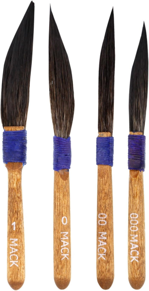

Below: Pinstriping brushes: About $66.00 USD for the set.

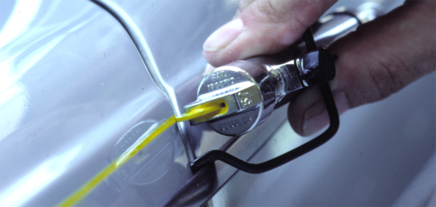

Modelers need not be hopelessly intimidated by Weisberger's superhuman skills, though. There are alternatives. One is the Beugler Pro pinstriping tool. It is a (somewhat pricy) "pen" with a roller head that accepts various sized "wheels" than are rolled over the workpiece, leaving a uniform stripe. Beugler makes a wide selection of accessories for use with their pinstriping machine system. (See: https://www.beugler.com/shop/professional-kit/)

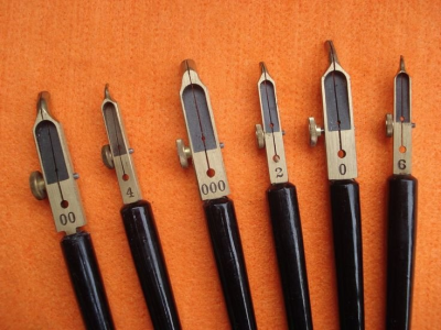

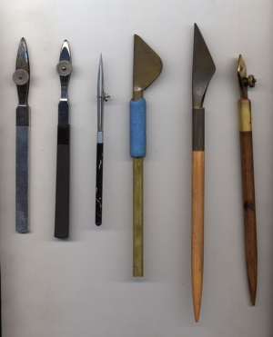

Below, L to R: Two adjustable linewidth "detail pens" which hold a large amount of medium, a standard adjustable linewidth ruling pen as found in most drafting instrument sets, two fixed linewidth patent "detail" or "border" pens," and a smaller adjustable linewidth detail pen.

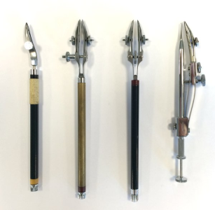

Below L to R: A swivel head adjustable linewidth ruling pen for drawing curves, two adjustable linewidth "railroad" or "highway" pens which draw two parallel lines with the separation between the two lines also adjustable, (These double-nibbed pens are also available in a "swivel headed" version for drawing curves.), a "drop point" or "rivet" compass for drawing very small circles with the interchangeable ruling pen attachment in place. (Note: Standard instrument sets usually include a ruling pen point attachment for use with the larger compass in the set and sometimes with a straight handle for it as well.)

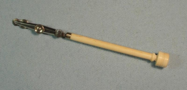

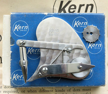

One old type of "dotting pen" which draws dotted lines, dashed lines, and combinations thereof. The image is made by interchangeable impression wheels which in this pen are contained in the drum at the end of the handle.
Below: A Kern (Swiss) dotting pen with interchangeable pattern wheels. Note the vertical ruling pen point at the left-hand side. The instrument is oriented as in use. As the guide point (left lower corner) is drawn along the straight edge or curve, a drive wheel is caused to turn which in turn causes the pattern wheel (gear disks as pictured in upper right hand corner) to rotate, causing the the spring-loaded armature holding the pen point to move up and down as the pattern wheel turns against it.

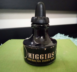

If you ever wondered why the classic India ink bottles came with eye droppers in the caps, now you know! :D

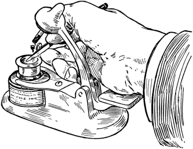

Below: And if you are ever lucky enough to come across one of these little cast iron gizmos made by Theo. Alteneder and Sons, an early American manufacturer and retailer of very high-quality drafting instruments, now you'll know what it's for and snag it.
It makes using ruling pens so much easier and spilling ink so much less likely. As can be seen in the pen and ink drawing above, the ink bottle's eye dropper is replaced by a post with a wire spring at its end. The wire spring drops into the ink and when it is raised by the heel of the draftsman's hand, there will be a drop of ink that has run down the spring and is waiting for the side of the pen nib to be touched to it, so the drop transfers to the space between the two nib arms. All done singlehandedly! And, it does not require any batteries! :D
