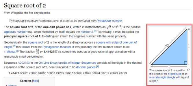

From a round dowel the maximum square you can make of course has a diagonal equal to the diameter of the dowel. The square can be divided into 2 right angle triangles and the hypotenuse of these triangles will be equal to the diagonal of the square. Thanks to Pythagoras we can calculate the length of the side as hypotenuse / square root of 2. Thus the max side of a square you can make from a 6 mm dowel = 6mm / √2 = 4,24mm :cool:

Not to be picky but square root of 36 (6x6) , not square root of 2. You are correct with the end result. You would need a 7mm dowel to get 5mm square. So I guess make a square and still add the 1mm planking all around to bring it to 6.24mm then sand down to 6 mm.
Haha :) I also don't want to be polemical but I think both ways are the same
and no need to make it that complicated. 4.24 is the maximum size. It is easily sanded down to 4 x 4 mm and if you then add 1 mm to each of the 4 sides you end up with 6 x 6 :D
