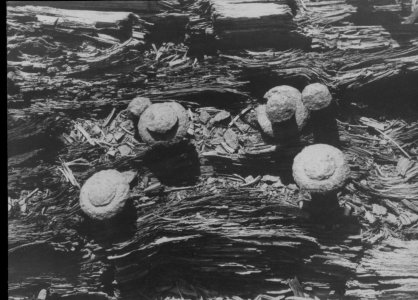

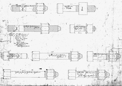

define "bolt" in wooden ship building a blot was a rod with a slit in the end
the heads were 3/4 inch so if .020= 1 inch at 1"48 scale at scale the bolt head is .015
or are you talking actual bolts used in steam engines? like these 1840

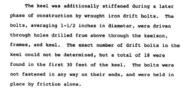

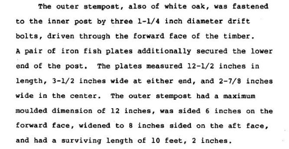

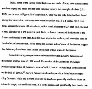

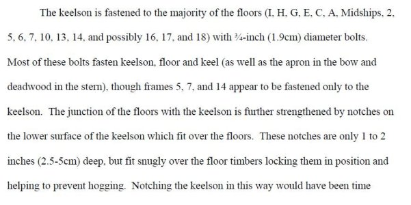

Going further to Roger's post, the size and number of the bolts used in the various parts of the ship varied with nation, era, rate, etc. For British ships the number of bolts and their diameter can be found in the 1719, 1745 and 1750 Establishments as well as in The Shipbuilder's Repository 1788 and in David Steel's The Elements and Practice of Naval Architecture. What ship and items are you looking at for the particular number and size of bolts?
The following is based on the book Ships’ Fastenings by Michael McCarthy published by Texas A&M Press:
There were two groups of metal fastenings; nails and bolts used in the hull structure of wooden vessels. The difference depended on size with bolts being larger.
Unlike nails, there were several patterns of bolts. First of all bolts were either though bolts or “dump bolts.”
Through bolts were either forelocked or clinched. Forelocked bolts had a head on one end and a slot in the other. A key was driven into the slot to lock the bolt in place. Clinched bolts were secured by hammering the end without the head over an iron ring. Threaded fasteners as known today were not used.
Dump bolts were really large nails. They did not pass completely through the joined timbers. Their principal use was to reinforce joints secured by through bolts. They could also be used to secure timbers during construction before being through bolted.
Both types were driven through holes that were slightly smaller than the bolt.

Revolutionary war era ships were NOT built with threaded bolts and nuts. The first two photos of Dave Stevens post #2 above accurately shows what these bolts looked like. The second photo clearly shows the bolt end hammered over its clench ring.
Roger
Roger
those pictures you refer to are the Argo so those bolts were still in use long after the Revolutionary war era
