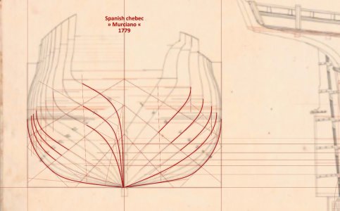

The ship I am building is Murciano, one of three great Xebecs and a chambequin (round [square} sails instead of Lateen). She is every bit the equivalent of a light frigate as to tumblehome and not at all what you would expect from, say, a Cazador or Mistique. That said, if you look at the gun-deck side wall of the first model ship the inside planking and outside planking look to be parallel rather than the outside being at a different angle. Of course, that is just one modeler's version and my poor eye-sight.
FYI, the plan book plan is "off" in several respects. First, it was actually in a book (crossing the seem) and the left and right sides of the capture are at different angles. Second, the body plans (at the top) do not perfectly match up with the sheer plan -- they are somewhat close but not at maximum amplification on a CAD. Next, the buttocks lines -- I think they are light grey buttocks lines -- do not appear to match a CAD model built from the body plan but even if they do, there is no demarcation on the top-down view of where they slice into the hull! On the other hand, the initial plan was just for a plan book.
First photo is Aventurero, an earlier jabeque made basically according to the plan book. The museum put the wrong rudder on her during repairs but the initial model ship was likely contemporaneous. Second model photo is a 20th century-made Museum model of Murciano showing the wrong sail plan (it shows Lateen rather than Round sails). Jpg of drawing of Murciano standing rigging is from me, with an early version by me of her hull.
Murciano is basically the plan book modified to make her larger and adjust the hull width/depth/length/keel ratios to produce a better sailing ship. She is also "Gautierized" -- the plan book was written under the Jorge Juan system and when Gautier took over he had his own signature changes. He was the kind of guy who didn't mind spending Spanish government money to redo parts ordered before he took over so that they conformed to his method.

My bad. The light grey dotted lines on the top-down view correspond to the outline created using the diagonal lines on the body plan.
When I was talking about how I see the gun deck walls on the Aventurero model it looked like the frame (C-D in my first attachment) was of uniform width -- as though line D was a perfect duplicate of line C rather than getting wider (stronger) as you run down this side wall from top to keel.
What I need to figure out is whether on the Jorge Juan plan book, with a Manga from inside to inside, the body plan lines (e.g., T) correspond to A (inside the inside planks), C (inside the frame), D (outside the frame), or B (outside the outside planks). Any thoughts on that anyone?
The last attachment shows buttocks lines derived from a 3d model complying with the plans (that do not show buttock's lines). Even taking into account the distance between body plan cut profiles and the impact on the CAD loft, the rear looks horrible. On the Murciano model I started fairing it and found that to get decent curves there I had to materially deviate from the body plan so I gave it up. It seemed like it was a choice between following the plan and materially deviating the hull shape. Maybe with your method I would have more confidence as no one wants an ugly hull.

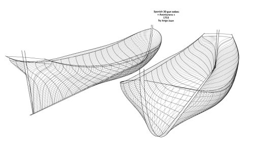

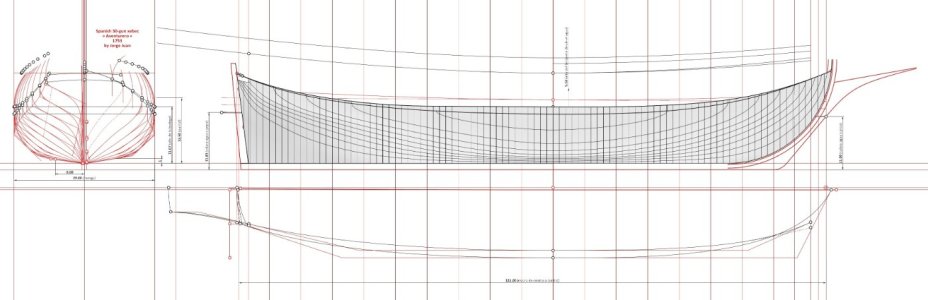

Below is a fragment of the plan for the xebec Aventurero 1753 to show the current stage of work. For now, the underwater part of the hull is complete, with the upperworks still to be done. I have not yet tested these lines by lofting 3D shapes.
Indeed, the coordinates on the various projections of the original plan are not consistent with each other, and in addition, the designer seemingly did not bother to draw the contours of the frames in a geometrically rigorous manner, but rather drew them fast-mode by feel. As a result, the shipwrights actually building this vessel may not have had an easy task with this plan.
Basically, when drawing the contours of the frames, I strictly based myself on the coordinates taken from the longitudinal design lines from the side and top projections, and in the attached diagram you can comfortably see all the resulting inconsistencies against the background of the body plan of the original plan.
1) I am glad that it was not just me, the plans are actually imperfect. These are stated to be the plans for Aventurero, though the dimensions vary slightly. Perhaps the builders felt the same way.
2) Outstanding work!
TYVM!
Thanks! And not bad for a first, trial loft. For now, I can only see one obvious area for improvement, and in almost every case it is quite a tricky area, that is, near the gripe.

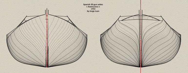

After correcting the contours of the frames (see post #15), which were not drawn very accurately on the original plan, both according to the diagonals (which, for a change, have already been quite carefully drawn as precise conical curves) and also according to consistently applied proper drafting and geometric techniques, time has allowed me to fully loft the underwater part of the hull. This is to ensure that there are no unforeseen complications at the very extremities of the hull.
Now it can be confirmed with still more certainty that the above treatment has yielded the fair shapes of the entire hull (i.e. its underwater part). In particular, the correction of the contours of frames #15, 18 and 21 has eliminated the ugly concavity of the buttock lines in the aft part of the hull that you showed earlier.

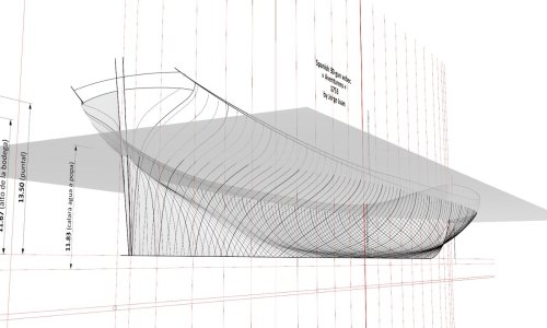

Below are a few graphics showing the current progress and the ultimately obtained check lines (waterlines and buttock lines) for the corrected frame lines of the original body plan.
By the way, joking a little, Allan should be quite satisfied, because in this reconstruction I incorporated the tapering of the keel (towards the stern) and of the stern post itself.
In any case, you can confidently use the corrected frame contours as shown in post #15 for your reconstruction of the xebec Murciano 1779.
