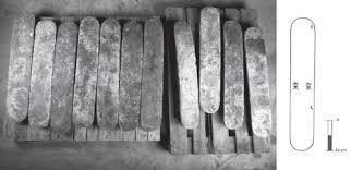

the stone ballast shifting fore and aft
I am pretty sure stone ballast or shingle was much earlier. Kentledge came into use in the early 18th century and would have been more common in your time frame. These bars would not shift in the hull. There are contemporary pieces in museums around the world and you can find photos on the internet. The approximate amount was typically 30 tons of ballast per 100 tons of rated ship tonnage
Approximate typical size
Allan, As usual thank you for passing on your knowledge and research. Greatly appreciated.
My pleasure. I just happened upon a lot of this information on ballast last week at a meeting with archaeologists concerning the HMS Fowey (44) 1744 which sank in Biscayne Bay in 1748 during a hurricane.
Just found an article on the Fowey that mentions the kentledge pieces weighed about 320 pounds each.
