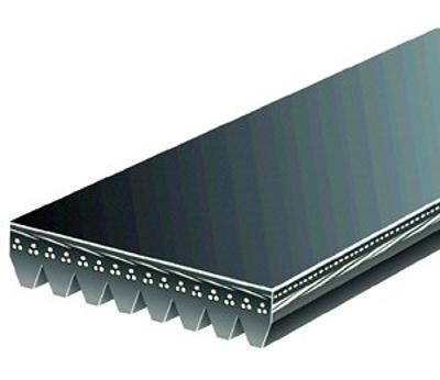

Your belt brand is Bando. It is called a Transmission belt
Specifications of Transmission belt BANDO 3PJ353​
TypeV belts
Belt trade sizePJ
System of measurementMetric
Belt length353mm
Belt width7.02mm
Belt thickness3.4mm
Belt angle40°
Minimum pulley diameter20mm
Belt materialRubber
V-Belt TypeBanded
V-rib pitch2.34mm
Number of ribs3
V-rib thickness1.3mm
ColorBlack
Load0.75kW or less
Highest speed50m/s
Application propertiesHighspeed, Smooth operation
Operation ambientFlame resistance, Weather resistance, Heat resistance, Oil resistance, Water resistance
Operating temperature-30...90°C
