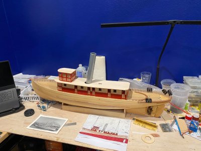

Thank you. This is my first time doing planking. If I had planned ahead a little better, they might have been more even. They get very narrow at the bow, below the waterline, but I am still pretty happy with the results. My wife even said it will be a shame to paint it.Well done sir. Excellent planking.![]()
It is indeed looking more and more like a ship, and it even sails and steams too. Great job!It has been a couple of rainy days, so a lot of work done with little visual changes to show for it…(binged ER episodes with my wife while fitting pieces to the hull!) Interior gunwale structure added and painted. Hull sanded. Lower side strakes added. Steamed and bent the stern bumper parts. They are temporarily clamped to the upper transom to fix their shape, but will be attached at the level of the deck.
It’s really cool seeing progress being made. Looking more like an actual boat with every step.
Thank you! I did find the source. It wasn’t the hull. It was the condensed water in the exhaust from the steam engine. The exhaust pipes were directed to the smokestack, and the water in that steam was running down, through the bottom of the smokestack, into the hull. I built a small tank to catch the water and direct it out of the side of the hull, and pipes to allow the steam to go to the smokestack.It is indeed looking more and more like a ship, and it even sails and steams too. Great job!
