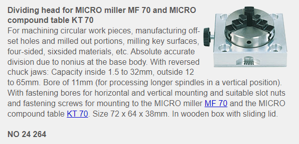

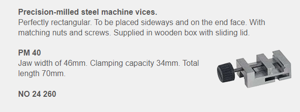

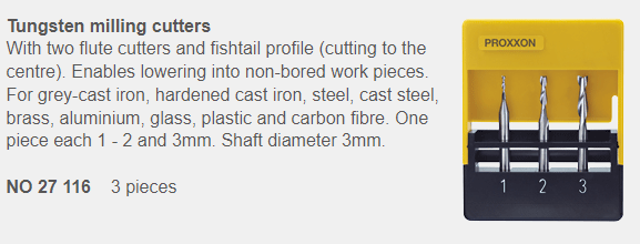

exactly, Nigel, if not cost more than the machine itself. For example, for Proxxon MF70 I'd say you may need, At least those three devicess. All three possibly cost around $180 -200 (depens where you buy them)
I have all three plus some additional items... The cutters came with the mill. Both clamping systems are a must and I'd like to get an angle clamp too!
Your point is spot on, but I think I got better pricing than you found.
