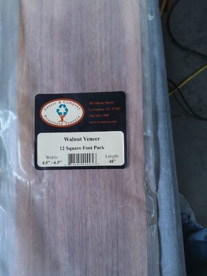

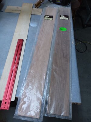

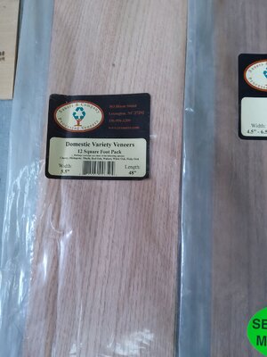

Veneer packs - good source of thin wood. I have several that will cover many uses. Different species make it easier to match the model.

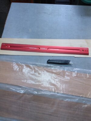

What's a good way to cut it into strips of precise and consistent width? My band saw would probably create rough edges.
I do it with a fine tooth blade on the circular saw. Some timbers are more brittle than others, ie. mahogany does not behave well. Some others (Pear, Costello) result in very good planks.
