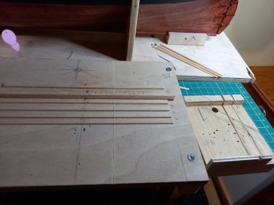

I had same problems in my first small miter box; the slots were wider than the blade of the saw. I built a new box and used my hand-held miter saw to cut the slots, along with accurately cut slabs of fairly slim wood clamped in place to guide the cuts. I had a small miter gauge to accurately set the 90 dree & 45 degree angles.
When in a pinch, I have used 3" X 5" file cards to accurately draw 90 & 45 degree angles. I hope this helps.
