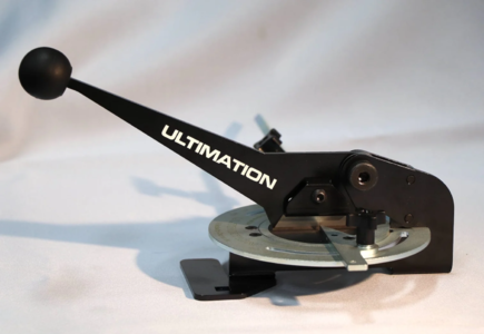

COR, hate to break it to ya, but I have to agree with stuglo. I’ve had one similar to this, along with Micro Mark’s “chop-it”, and they both work great if you’re not cutting anything harder than small balsa strips. If you want to (accurately) cut the harder woods, you’ll need to step up a bit. Just having this similar conversations on another thread, but the other end of the scale is the Ultimation Slicer. For me, it was a buy 3, cry 3 times, but it’s the last one I’ll ever need.
here is the image for the Ultimation Slicer FrankW mentioned, and the link
