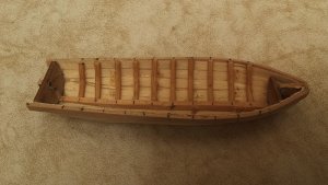

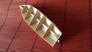

Thanks for your replies. The scale is 1:78 at it is scratch build from plans. I have posted two photos of the boat. I glued the .5mm strips to the bulkheads. Do I have to do second planking and how to remove the bulkheads? I think that I am doing something wrong.
HI, Joe. A second planking is normally only needed if the first is not sufficient to form a hull successfully.
When you do a small boat that needs the bulkheads removing, you normally only glue at the first and last bulkhead.
Anyway this is easily fixed.
Give the inside & outside a thinned out coat of pva. This will bind the planks together. In your case a second layer will help.
Remove the middle 4 bulkheads one at a time with a side cuter and trim back with a no 11. Cut to keel level as the floor will be covered.
Mot boats have ribbing so once you add this it will firm up.

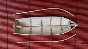

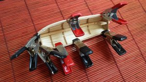

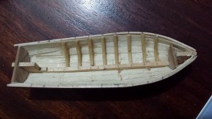

After I did the second planking and put the filler I removed the buklheads with a side cutter. I have to sand inside the boat for smooth finish before I glue the ribs. Bending two strips for the sides and glued as shown in these photos.

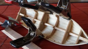

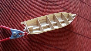

Removing the bulkheads and cleaned by sanding inside with a cordless multi grinder, I started cutting and gluing the ribs on one side.

Step by step a big improovement ..... the boat is looking much better
