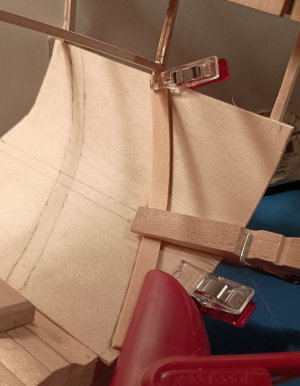

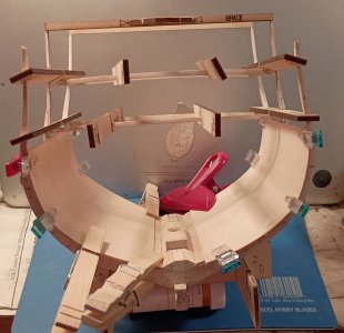

After reading about problems people encountered because of the frame deck beams, I decided to mark the top positions of the orlap and berthing deck beams on the end frames, label them, then cut them off of the frames.
It really opened up the lower areas, making it much easier to work.
I'm also combining the hold and berthing ceilings into a single piece of 1/16 inch basswood on each side so the diagonal bracing can be modeled more accurately.
