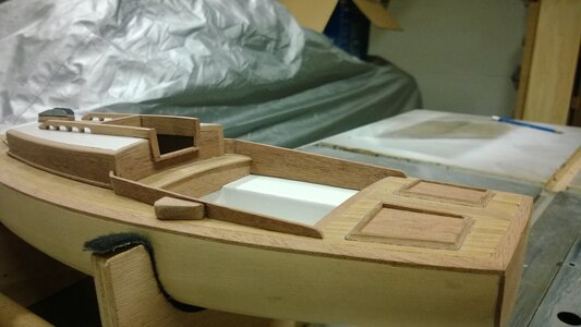

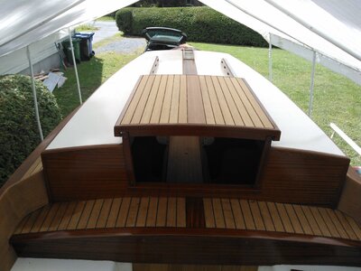

10 years ago, a sailor friend of mine asked me if I'd be willing to build him a wooden 24 foot sailboat around an old Shark 24 fiber glass hull. I could'n resist. So 2 years later he had a nice wooden sailboat.enfin a l'eau.jpg

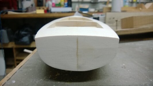

The thing is, aside from a shop full of wood scrap, I didn't have anything to remind me of the project. So I decided to scratch build the boat at 1/16 scale.

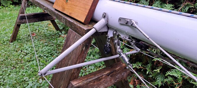

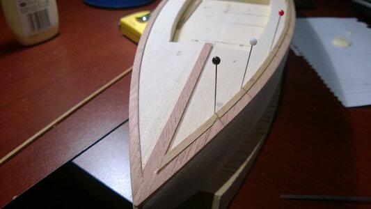

OK, so I started or rather continued this scratch build and here's what been done to date:
(I'll try to post a picture of the real feature next to the scaled one)

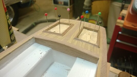

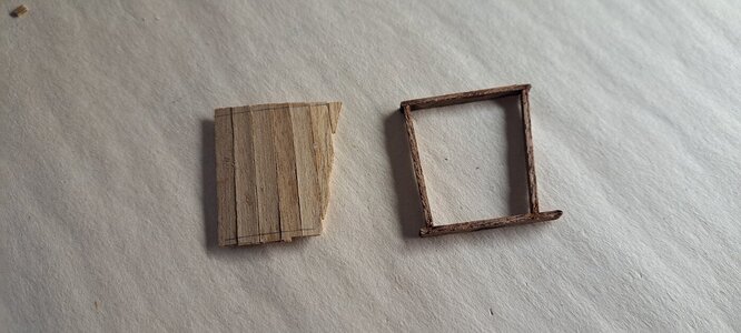

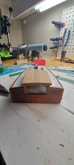

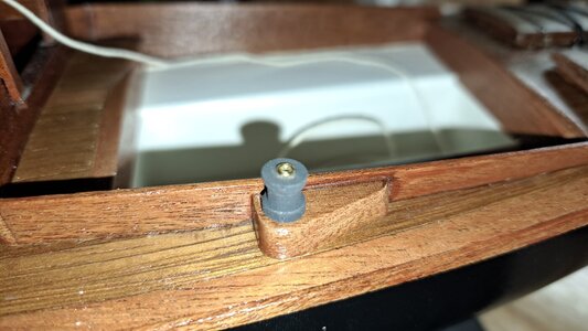

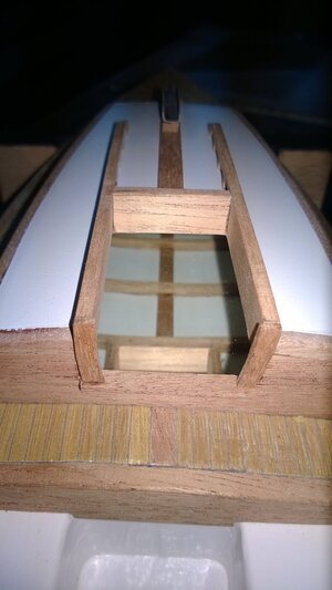

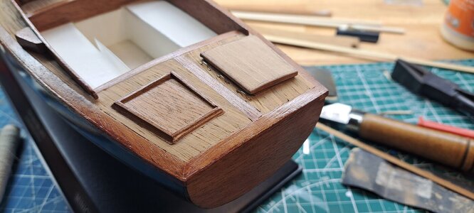

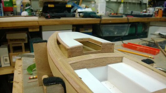

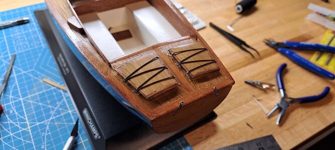

1- all hatchs done along with tiny bungee cords and hooks

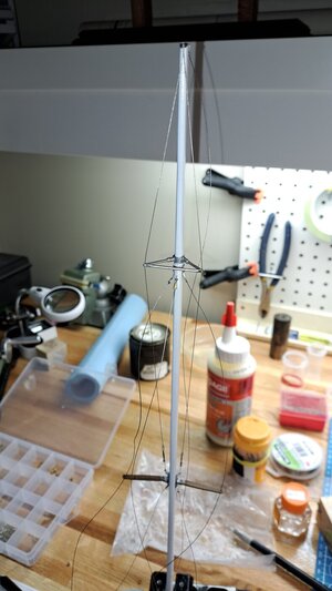

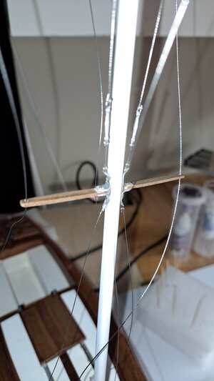

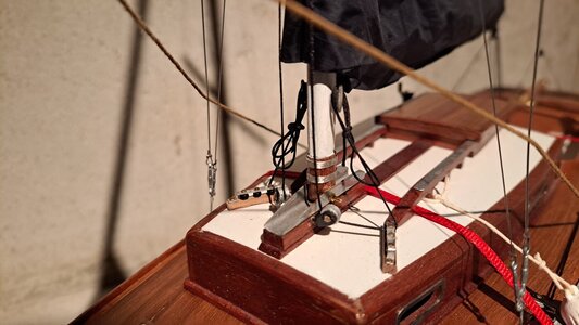

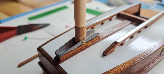

2- main mast with custom base

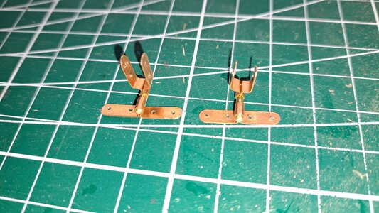

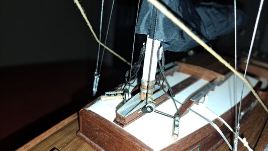

3- many rigging brackets
1- hatchs
20220926_114754.jpg20220927_074640.jpg20220927_193323.jpg20220927_212128.jpgWP_000239.jpg
Main mast base
Rigging brackets

Here's where I'm at:

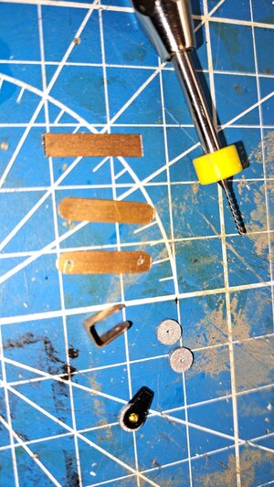

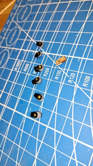

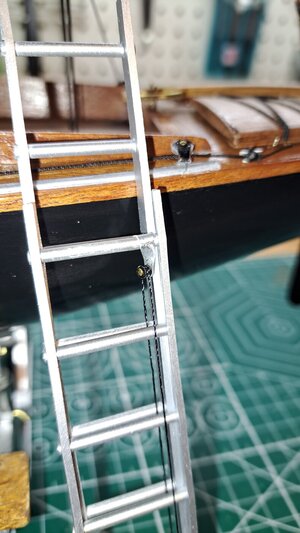

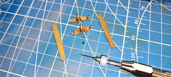

1- mini pulley fab
2- rigging pretty much complete
3- winchs installed
4- bow railling

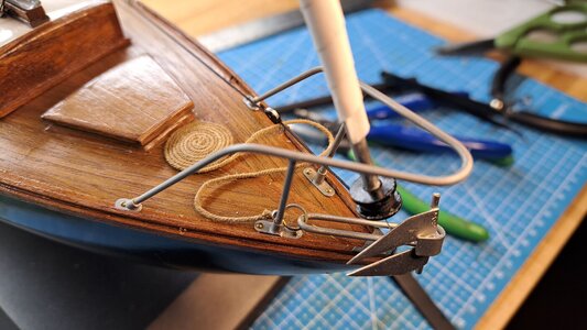

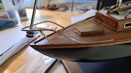

5- furler and jib sail installed

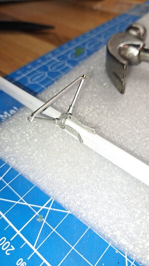

6- anchor fab
7- main sail cover

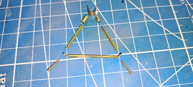

1- mini pulley fab
20221005_141414.jpg20221005_142034.jpg20221005_163850.jpg20221005_163917.jpg20221005_163909.jpg20221005_122533.jpg

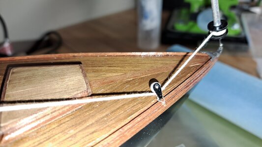

3- winchs installed

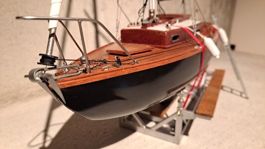

4- bow railling
mockup
5- furler and jb sail installed
the rope will be replaced by a chain that will go down into a chain port (not shown yet)

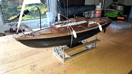

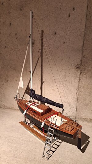

so here is the last post before showing off the finished model
1- rudder and rudder bar
2- cleats (I finaly received them)
3- bumbers
4- boat cradle

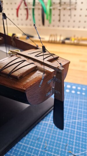

the real rudder bar
rudder bar raw material
bar lamination
carved rudder bar with gripping rope and handles
completed rudder and bar assy
and installed

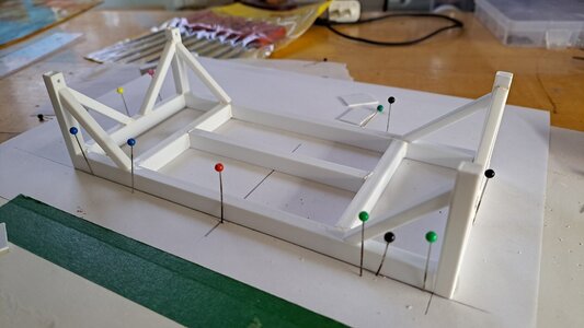

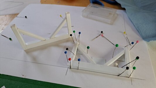

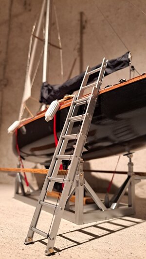

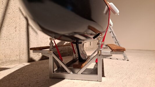

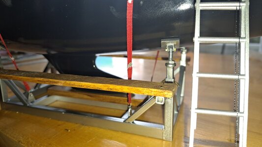

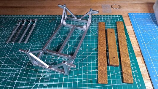

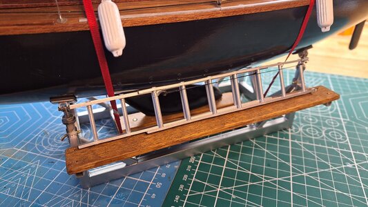

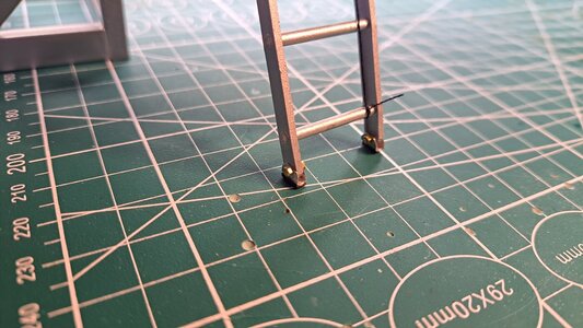

4-boat cradle
first, let me introduce my new best friend, Styrene Plastic. I think we will do some nice things together, this stuff is really fun to work with.
support pads fab
and assembled
notice the welds, they were done using Vallejo plastic putty
I should be posting the finished model soon
