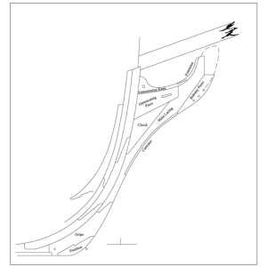

I would certainly be interested in your thoughts, particularly on the knee of the head section.

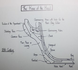

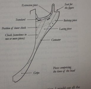

I just read the section on the knee of the head. This in itself is the most thorough examination of this part of the ship that I recall seeing. I doubt that there were two ships exactly the same so it might be anybody's guess as to the details for Perseus or her sisters. In the end, no one can say whatever you choose for that era is wrong. A few that come to mind that SEEM to be somewhat common are below. The second is from Goodwin. The last one is by David Antscherl in volume I, page 137 of The Fully Framed Model. He states that The knee of the head varied, depending on the timber at hand, but there were several principal pieces.
So one of the interesting things that drove me to try and document all the historical examples of the knee of the head was the lack of justification for the designs I saw in most of the secondary sources. The Goodwin example you show above is interesting, because in earlier drafts I actually included it in the discussion talking about how I could find no contemporary examples that looked anything like it. But that style of arrangement I have seen all over the place in secondary sources and modern models. Now it is possible Goodwin was working from some unnamed contemporary example, but I suspect that his arrangement is not consistent with contemporary practice.
The arrangement David A used in the TFFM is I think broadly consistent with the examples I have found, I didn't include it because I was again focused on contemporary examples.
In general I am of the view that the knee of the head in English shipbuilding was generally made with more pieces than most modern models depict. I suspect the use of scarfed joints was also quite common, though not universal.
If anyone is aware of any contemporary depictions or descriptions of the components of the knee of the head that I have not documented I would love to see them.
