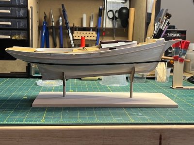

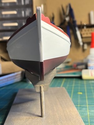

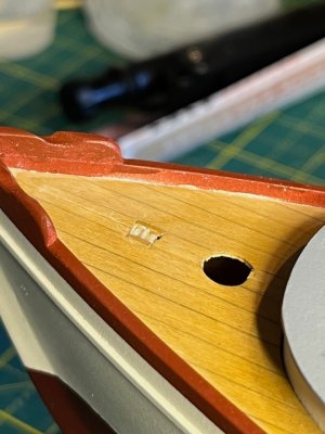

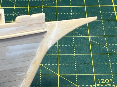

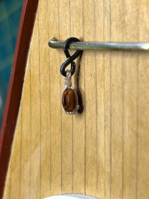

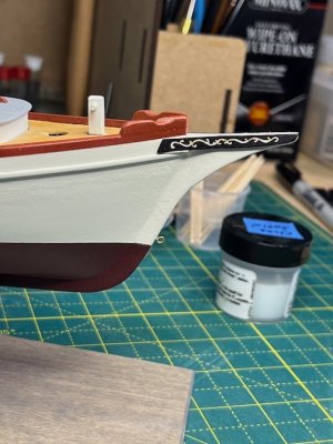

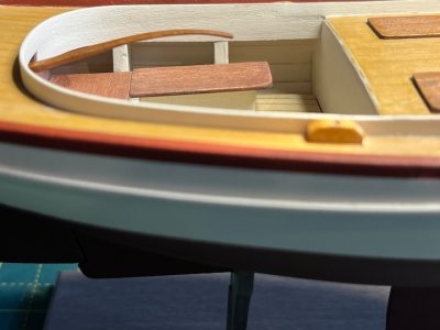

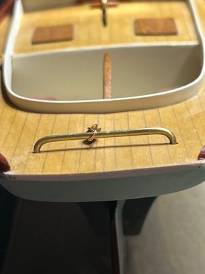

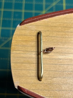

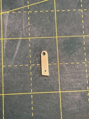

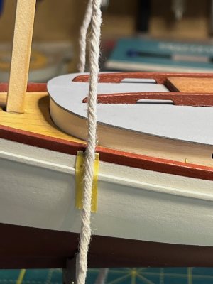

It was a glorious weekend here in New England, so most of my time was spent outside, in the yard or on my real boat. I did manage to make the second chainplate (and center the holes much better) and install them both. I bent them before installing them 2.25" behind the trail boards. I marked and drilled holes using a #70 drill bit, and trimmed the brass nails before inserting them. They are only going through the sheer strake, so are mainly there for show. I used CA glue to attach the chainplates before inserting the nails.

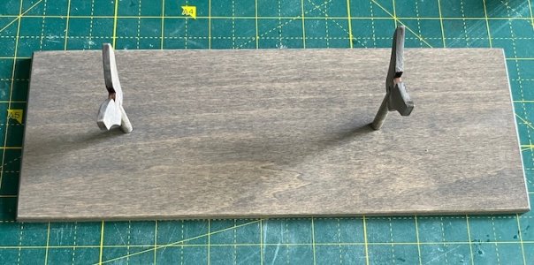

I then cleaned up the cleats using diamond jewelers files. They did a great job. You can get a set of 5 different shapes very cheaply on Amazon.

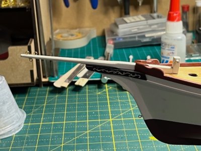

I sprayed them with gray primer, and then painted them with Folkart Metallic Nickel craft paint, hoping to mimic galvanized iron. My research indicated that bronze was also used, but I that seems excessive for a working boat. I understand the iron would eventually turn black, or be coated in tar, but I think of my model as a boat fresh off the "assembly line," as it were. Plus, I like the color.

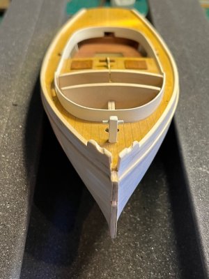

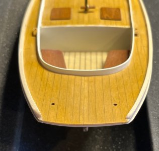

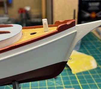

I used 5 minute epoxy to attach them. I'm glad I did, because it took some fiddling to get them where I thought they should be. I did the bowsprit cleat first, as that seemed easiest.

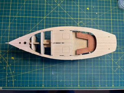

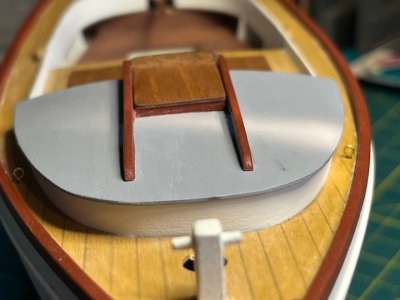

I tried to line the side cockpit cleats with the top of the deck over the wet wells.

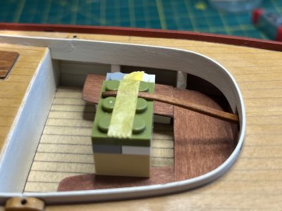

I very slightly bent the base of the cleat over the tiller, as recommended in the instructions. It didn't need very much. The final result:

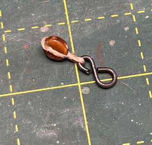

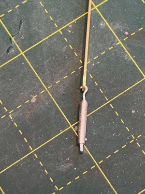

The instructions have you attach the turnbuckles now, but I can't think why. They will only be in the way and continually fall off. I will add them at the appropriate time during the rigging. However, I will clean them up and paint them now, before moving on to the mast.
