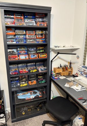

On another note, once the B-25 is finished I will have to clear off my shelves with cars to start using for my remaining aircraft.
I sill have room for 4 of my remaining WW2 aircraft on the other shelves. But I have 14 left. And the shelves for my jets still have room for 14 more. But I still have 19 left.
So that’s 15 that I have to put on the car shelves. In addition I have 10 more WW1 and biplane aircraft to build. So that total of 25 aircraft have to be placed on the car shelves.
In short, cars have to be boxed or sold. ;)
