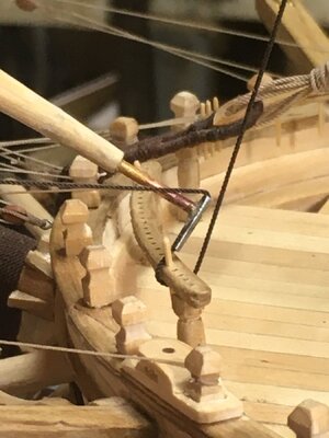

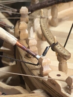

I was having much trouble belaying on belaying pins and cleats and I came up with this. It's a piece of a syringe tube soldered on a wire and stuck in a chopstick. I just thread the rope through through the tube and reach the tube back and forth around the cleat or pin. It works better than I had hoped.

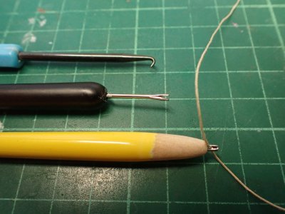

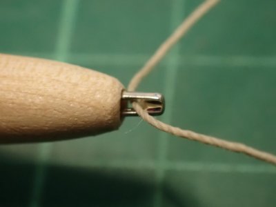

Sweet! That’s what I love about modelers. There is no problem that you cannot find a solution or work-around to. I’m impressed and going to get the supplies to make my own. Thanks!
