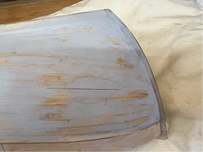

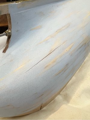

Hi,
I'm building Billing's Mary Ann, a POB build. I finished the the planking at the end of May, and it has been coated with two part epoxy on the inside, and sanded and filled on the outside two weeks ago. I was just finalising a few things before starting the prime and paint stage, but when I went out to have a look at her today I find 6 or 7 longitudinal splits in the planking - the planks have separated. Yesterday was an unusually hot day here - I'm in Australia, so still winter, but 29C and a very dry wind. The hull was indoors, and out of direct sunlight, but I assume that the combo of heat and low humidity has caused my problem.
Here's a couple of photos...
It is a single layer of planking. The timber is called Obechi in the Billing parts list. It was soaked before bending, and allowed to dry while pinned on the frame before being glued. I've used slow CA glue to the bulkheads and along the edges of the plank. Although the kit is a static display model, I am building it as functional RC model, so it will need to be watertight. I'm not sure what to do from here, other than to sand back the affected sections and capillary glue before continuing on.
Thanks for any suggestions...
It is the combination of high temperatures and low humidity that has caused the problem, not your fault and not really the fault of the material - it;s just doing what wood will do under fairly extreme conditions. I would try filling the cracks with epoxy and reinforcing the on the outside with strips of the lightest weight model aircraft tissue paper you can find, also fixed down with epoxy. The thin tissue should vanish under a coat of paint and help to stop the cracks re-appearing. Others may have better ideas.
It looks to me that it has split along a joint between 2 planks which to me indicates no glue between the planks at that point. Presss on the joint to see if it is because the wood planks have come away from the bulkheads or if it is because the wood has just shrunk away from each other).
If it has come away from the bulkheads to split, I would try to put some slow CA in the gap and then put plastic wrap around it (to prevent it from sticking to things to hold it together during curing). After the plastic wrap, I would put a square piece of wood (you might have to pre-shape it to match the curve of the hull along the length) right over the crack and clamp it down to try to close the gap.
If it has split due to the wood shrinking, I believe all you can probably do is to fill the gap and re-surface. One of the things I've done on RC planes to fill and resurface is to put some slow CA in the gap and hit the surface with some sandpaper. the sanding dust will mix with the glue and give a good strong finish with a decent surface. Yes, it will also destroy the sand paper where you use it to sand. :)
Thanks Alan & Jeff for the replies. The splits are definitely between the plank joins, and all are between bulkheads, so I think you are right in saying I didn't edge glue well enough (a handy lesson learnt for this beginner). Fortunately all of the splits appear to have just pulled away from one another, rather than popped out to create a bulge...so I think I'll do as suggested and force some glue into the cracks and re-surface. I'll try both suggested techniques for finishing (tissue and sanding dust) and see what works for me. I guess I can only cross my fingers that it doesn't happen elsewhere after painting.
Brother Pete:
Wood swells across the grain as its moisture content increases. In this case, you attached the planks after soaking and they were then subjected to low humidity air resulting in lower moisture content and shrinkage across the grain. As each of the planks shrank a little bit, the accumulated tension across the planks caused failure at the weakest glue joint in the area. I would be inclined to try thin CA glue in the cracks built up as needed with sanding dust. The thin glue would provide better penetration through the cracks than the thicker type. If you were to use a laminate, whether tissue or fiberglass, I would apply it to the entire hull to avoid odd patches. The most common practice with RC boats is fiberglass and epoxy lamination on the entire outside of the hull. Please keep us apprised of your progress. And send along more pictures. Fair winds!

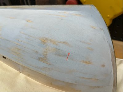

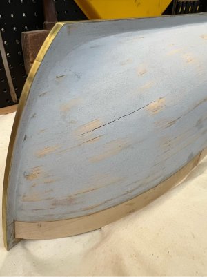

Thanks Andy. The thin CA is a good idea for penetration…but I’d already tried the thick & slow CA technique before reading your comment. I decided on the slow CA and sand across it as it dries…because it was simple, and I had everything at hand. It worked very well on the first crack and I just kept going. I first cleaned each split with the back side of a scalpel blade, to open it up a little at the surface, but not actually cut anything out, then used the nozzle of the slow CA against the opening and I think I got pretty good penetration, I then gave it a quick wipe at the surface, then sanded across it with 180 grit. This appears to have filled the slot nicely. I let it dry naturally. In a few cases I gave it a second coat to better fill to the surface.
I’m sure that the epoxy and glass mat approach over the entire hull would be best in the long term, but I’m not comfortable in my ability to get a good finish at this point, so that will have to wait until a future model.
Here are a couple of photos. Also note that yesterday was even hotter, and equally dry, as the day that the splitting occurred and I didn’t get any further splitting, so hopefully we’re now below the point at which any residual stresses will create more splits.
Split ‘opened’ a little with a blade…
After filling and some re-finishing…
Thanks to everyone for your help.

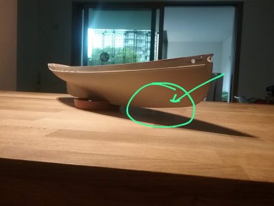

The sole effective method to stabilize the planking over the years and to achive a perfect smooth surface without evidence of coaming between the wooden strakes is to laminate a thin (30-50 g/m2) cloth o fiberglass on it. Once primed, you will get somethin' near to plastic moulded object. For the very semi-hull in my avatar, plank on bulkhead made, I adopted that solution. The same with my last completed project - the Americas cupper "Puritan", you can work out here on SOS. Cheers! Alberto
PS. I checked out that pic rappresenting a big shake in Puritan's planking before fiberglassing.
