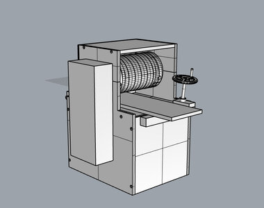

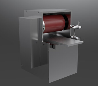

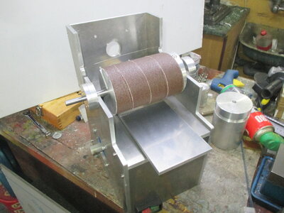

Thank you for all the words of appreciation. I've already done a few things commercially. I am currently designing a newer version. The construction of this machine is laborious and time-consuming. I do everything myself on manual machine tools
Parameters:
working width 100 mm
thickness range 1mm - 20mm
rotations of the drum 1400 rpm
Engine power 1.1 kW 230 V.
chip evacuation hole
dimensions 160x160x280
weight about 12 kg
It is best if I have orders for a minimum of 5, then I can do it faster
The cost of the machine is approximately $ 399

very interesting machine !!!
Maybe you can tell us also the differences between this machine and the newer version and how long it will take for the newer version to be developed?
Good that you have a connection on the top for the dust collection with a vac.
Also good on the version you show in the video is the possibility to fix the thickness with a lever, the photos are not showing this lever.
One question: How long does it need to change the sanding paper, in order to change the grid? because often you want to sand first rough and the final touch with a more fine grid.....

I will show a new project soon. the main changes will be the spiral abrasive attachment

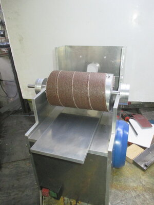

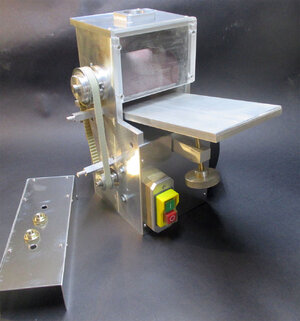

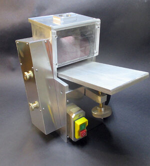

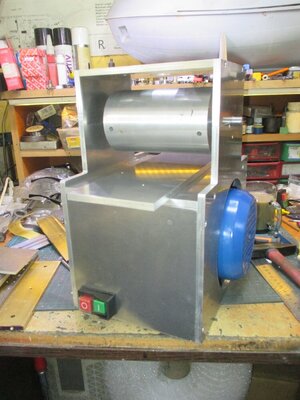

Hello
A new version has been created
the main changes are the attachment of the abrasive cloth. Now we attach in a spiral which increases the durability and efficiency of grinding.
Raising the table is now more precise and has been moved upwards for easier control
I used a DC 24v 500 W 3000 rpm motor with a speed reduction to 900 rpm with a ratio of 1: 3.
Now the power supply can be 110v or 230v
If you are interested, please contact me so that I can arrange the details.
I don't know if there is a need to install smooth speed control?
I am waiting for your feedback suggestions

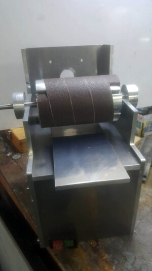

Hello
The new version is nearing completion.
The photo shows how the abrasive will be attached to the drum
