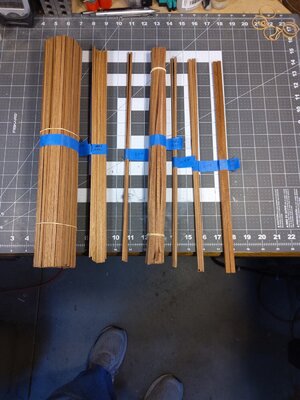

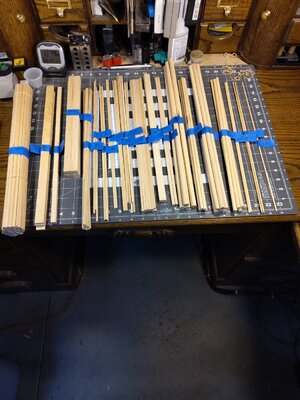

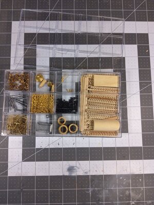

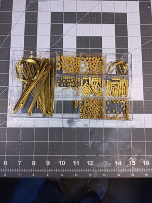

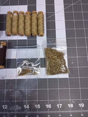

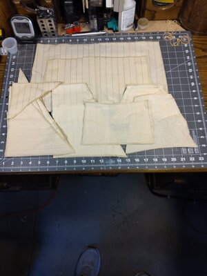

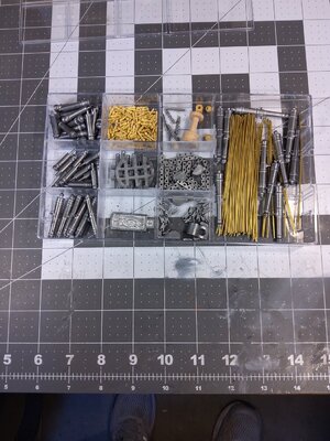

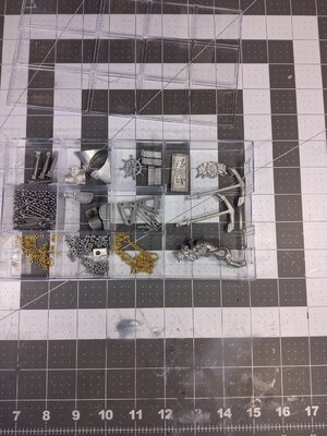

This morning I separated out the lumber, measuring and labelling before I start the build. Also opened the 4 boxes of parts and two envelopes containing sails, threads and some hardware. I also went through and numbered all the laser-cut items as they come unnumbered.
20211030_131117.jpg20211030_130744.jpg20211030_130453.jpg20211030_130439.jpg20211030_125744.jpg20211030_125740.jpg20211030_124833.jpg20211030_124624.jpg20211030_124410.jpg
Interesting to see the content of this kit......
You made already the photos, would be great to make a new topic with a small box opening or kit review

Once I start the build, I'll start a log and I'll include a complete kit description with contents. I have first to build a display case for the model I just finished. I am just now designing it in CAD and will build it in my wood shop soon. Since I am retired, I am not on any strict timetable.
