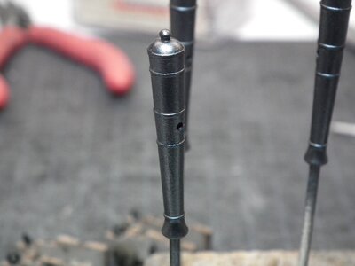

Hi gang,
just wondering if there's a hobby paint in a spray can that resembles a true metallic black for painting cannon barrels ?
I would prefer not to use black, but something that gives a metallic look like the photo below-
Thanks in advance.
.View attachment 183148
Are your barrels wood or metal. Each can offer different finish options. Modern gun bluing is actually that: a dark blue almost black as you have probably seen. I don't actually know what the finish was on gun barrels that were not bronze in the 1800's. It may be a similar speculation to what the actual surface color of decks were that were holy stoned regularly and not as we see them in "walk-on" tours of the old ships now. I'll check with my younger brother who is a walking encyclopedia of ships of war, British and French from the Napoleonic era. The works of Jean Boudriot may give some information. PT-2
Humbrol once did a range of metallic enamels collectively called 'Metalcoat'. These were buffable and looked just like your example.
Showing my age here, but when I was young, it was common to see old cannon embedded in the streets as bollards. I don't recall seeing any substantial rust on them; where they were touched regularly they developed a sheen much like the finish produced by what we called 'Black Lead', a paste once used to buff onto iron cooking ranges. The rest of the surface was a dull satin black.
Later, copies were made (with a distinctive casting ridge along their length) which did rust when the black paint was damaged or worn off.
I'm no metallurgist, but I do believe there are some cast iron alloys that don't rust.
Hi Brian, I have used DecoArt Charcoal from the Matte metallics range.
This was/is available at the arts/craft section at Bunnings.
I use a lead pencil to highlight raised sections and it gives a good result.
Thats a good idea Jim, think I will try that technique. :)

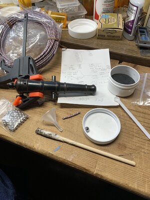

I have attached a photo of the steel barrel cannon that I turned 40 years ago but only fired it for the first time today with a black powder charge for a 9/32 inch ball bearing. Even with a 2/3 charge starting trial it was very effective in the shot. This finish may be something like you are looking toward but I cannot say a paint color so your prior suggestions in trials will lead you to your desired appearance. Scale will also be factor. This barrel is 5-3/4 x 7/8 inch max diameter. Not having the carriage completed I used an F-clampCannon Firing Components.jpgPT-2
I swear on using TAMIYA flat black and graphite powder afterwards.
