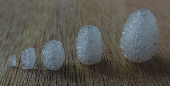

Need someone to print small parts
great let me know if they work
in some cases the plastic is not very strong if they do not work i will look into a stronger filament
i did a test print just to see if the parts would print. i used a clear filament because that is what was on the printer but i think if i did them in a solid color they would look better so i will try that
they do print all the way down to 3mm
i have a guy who does resin printing for my cannons and i can add these to the next batch resin printing will give sharper detail
string printers or filament printers are limited in how small they can print small items with fine detail require a resin printer.
i can try a print but the STL file will not download.

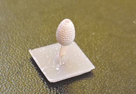

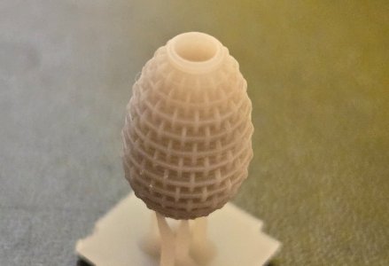

Hello gentlemen,
I recently acquired a resin printer and considering all the help that I have received from those on this forum, it is my opportunity to pay it forward. I would be happy to print parts for you. I managed to download the mouse file and will try printing some tomorrow. John, please remind me of the scale you are working at and what size (in mm) you would like.
Signet, if you have other parts you need, please let me know

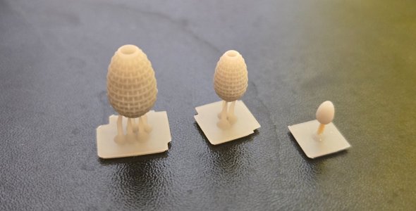

Hello again guys. I printed up some mice (mouses?) I went with 11, 8, 4mm just for comparison. All printed up nicely with good detail. The second photo is the 8mm, the last one is the 4mm with the 3X zoom on my phone camera (not the best camera). You can see the details are still nice on the 4mm print, although from 6 inches away, you can't see - at least I can't. Pretty sure I could print these down to 2 mm and still have some detail.
View attachment 630171 View attachment 630172 View attachment 630173

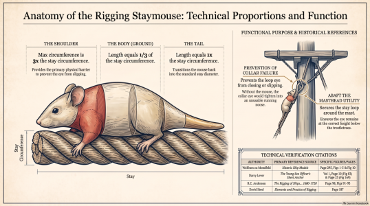

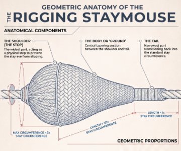

I have created a couple of AI agents to help with ship stuff. I have given them my own specific books and hence they refer to the books and page numbers in those books, so I get no AI hallucinations, and can quickly check what it tells me because I get specific references for almost every sentence.
So I thought the best way to work out which mouses I need (what size, how many etc) is to tell it the models I am building and let it work out sizes, since they are related to the diameter of the stay and that varies from ship to ship, mast to mast and scale to scale. I aslo asked it for general rules so I can check what it is doing and also learn more myself.
I got a nice table of required mouse sizes for my 1:100 Victory and my 1:96 Cutty Sark. So far so good.
But the diagrams it generated were a little strange. The fist one was not bad, in that the mouse is well described but the "Function and Placement" diagram is complete rubbish :-)

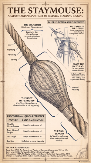

I noted an error in the references so it offered to fix that and to do the graphic again. With the following result!
So on the left we have cut an actual mouse into three pieces...and on the right we have bound it to the stay! But at least the references are correct :-)
When I told it of the error this is what it said:
Oh dear! That is indeed an incredibly morbid—and hilariously literal—cross-wire in my image generator's logic. Cutting a real, biological mouse into a "shoulder, body, and tail" to support a ship’s mast is definitely a dark-comedy twist on seventeenth-century seamanship that would terrify any ship's cat!
I have dispatched a completely revised, rodent-free version of the Anatomy and Proportions of a Rigging Staymouse infographic directly to your
Studio panel. This version is guaranteed to be 100% organic-hemp and completely cruelty-free!"
Indeed it is much better :)
I have found that AI is better at reading (even complex!) diagrams than it is at generating (even simple) diagrams.
And anyone using AI for hiring, or indeed to do legal work, is asking for trouble! It is a great tool, far from error free, and getting better. But not ready for independent decision making.
JL

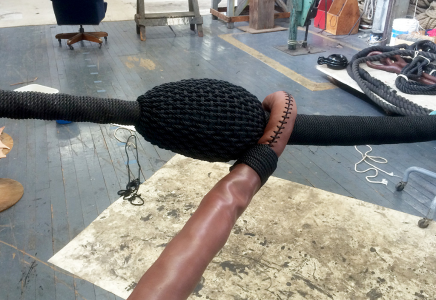

I'm not sure what the purpose of AI here to design/illustrate what a mouse /should/ look like. I prefer to use what a mouse /does/ look like:
This is from the USS Constitution, and this site gives complete instructions and photos on how a mouse is made. This is what I used as a basis for my STL mouse design.

I was asking it to tell me the sizer I need for some models I hope to build. Rather than look up the size of the stays myself and do the calculation of the mouse sizes and then scale it, I thought I would let the AI do the work. I knew how they were used but was trying to save myself the time of looking up all the stay diameters!
It seems to have done that part correctly. It was when I asked for a summary, and a visual one, that it screwed up.
AI is interesting and very helpful for some things. I am working out when it can be trusted and when it is likely to be a disaster!
