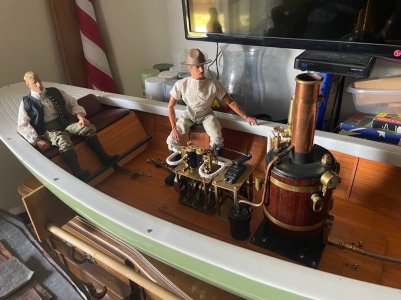

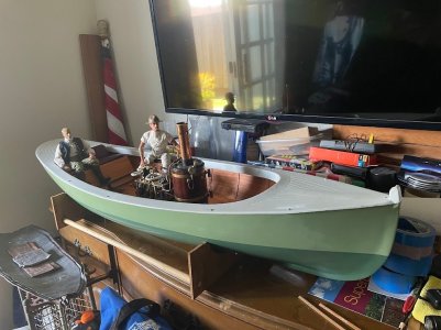

New 957 Midwest "Seguin" Steam Tug by Model Expo.

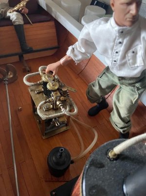

Two cylinder Krick steam engine. The nice part about this little engine is that it has no dead centers so forward and reverse are an easy switch of pressure flow through the engine. No reverse gear.
Ballast is rows and rows of 45 cal. lead balls laid in a few at a time paying attention to fore/aft trim while floating in the bathtub.
Funnel is a 1 1/4" chrome plated brass sink tailpiece that I chucked up in my lathe and sanded off the chrome. The bottom part is fabricated from sheet bras.

I had a little mishap the last time I raised steam in her and damn near burnt her to flinders. Luckily I was running her in the pool without the cabins in place so I was able to spot the flames immediately and splash them out. It was a bright sunny day and I couldn't see the butane flame well, and had set it too high. Burnt the boiler lagging and charred the insides of the deck.

I have the later version of the Krick engine (model II) that I plan to use in my 50" Hartman Diana launch. My concern is that it may not have enough power. It's a pretty big launch. I did a few bench tests with the Wilesco/Krick vertical boiler and I couldn't get more than 30psi. So I have switched to a Cheddar Puffin vertical 9 flue boiler. Lots more steam!
So I know the Seguin is a bit smaller than my launch but how did the Krick perform?
