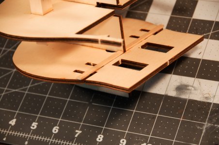

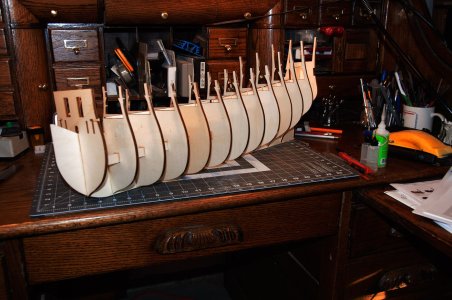

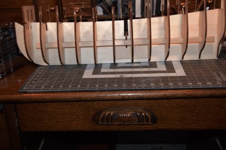

You have what’s known as a POB, Plank on Bulkhead kit. The principles of building these are the same for all such kits, simple or complicated. There is a central spine, commonly called a false keel. The bulkheads are glued crosswise each into its respective notch to provide the skeleton of the hull. You then add the planking to the hull. Some of these kits require two layers of planking. The first supports the second finished layer. Check out build logs here on the forum to get the idea. As Dave says proceed step by step. Don’t worry about future steps until you’ve completed the hull.

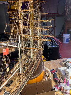

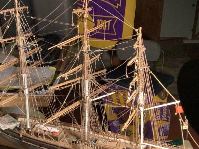

Jay, I am relatively new to the hobby and I suggest you do what I did. Do a search on youtube and you will find many videos on building various ships. There are guys who have 50 to 90 videos on building a ship step by step. Find the video or person that you like and can relate to and go buy that model. I build the Occre HMS Beagle as my first ship and build along with this video series.
It was a totally enjoyable project and I learned so much. Very nice to be able to watch someone do step by step when you are learning.
Roger
