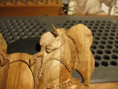

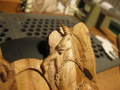

I’ll show you today’s work here; I didn’t have much time, so I couldn’t get much done. I did, however, accentuate the muscles a bit better and gave it a nice, smooth finish. I also carved out the contours of the horse’s head. The area between the head and the neck strap is hard to reach with the cutters or the small chisels. So it took a lot of scraping. More work to be done, but first the head. Why is it inaccessible with the cutters? The tip of the handpiece hits the other parts that are already finished, and that could damage them.
I’ve now posted three photos, taken from three different angles. Hopefully, this will give a better idea of what it looks like.
The head of the original is in my opinion a little to small. But I'll keep that in the model.
Weekend update. I still need to adjust and refine a lot of details. Like the mouth—it’s a bit too much. The rear nostril needs to be raised slightly by trimming the bottom a bit; the ear hasn’t been done yet, and the mane behind the head needs finishing. The contours of the face also need to be a bit more refined. I’m happy with the eye and the horn. But that mouth—I can see the problem in the macro photo, too. That’s going to be quite a challenge, because even my finest bit is still too big for details this small.

Thanks Herman, yes these things are not visible with a magnifier. And in real you see 3D, but the macro's are 2D. But also good, they show you what mistake you made and how to solve it. Tomorrow I will give it a shot. And when it goes wrong, I glue an extra piece of wood on that place to start it again.

Hi Stephan, it is not the lack of your carving but the quality of the modern phone camera's.
The carving look great and with the naked eye you don't notice any defect you see with a macro.
Great job.
Thanks Maarten,
you're right. I cleaned the surface and did a little on the mouth of the horse. Trimmed the nose and get those mussle a little tighter. I leve it like this.
