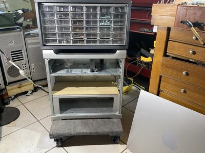

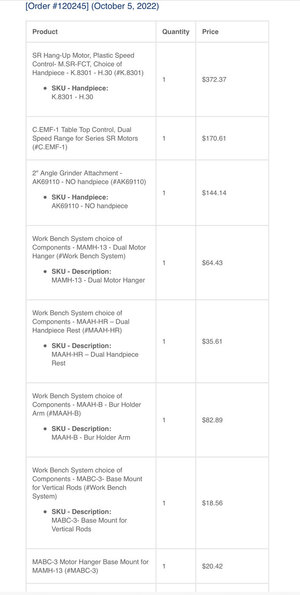

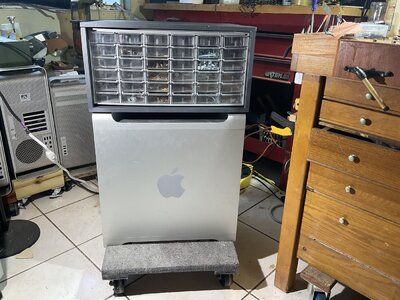

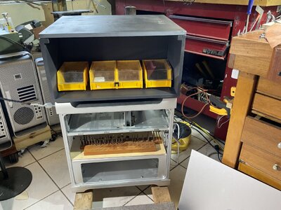

I have now purchase the Foredom with the following accessories and made up the base using two MacPro computer bases. Just waiting on everynthing to arrive now. One side will hold the accessories for the Foredom and Dremel while the other will be for all my soldering tools and accessories.
