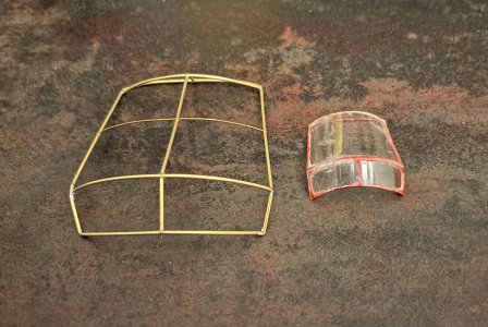

There is a windshield, although I know the Israeli Kolibrie's flew without during summer. The windshield will definitely be added, actually the basic frame work has already been fabricated. The picture below shows the 1:24 windshield left and the 1:48 windshield trial fabrication on the right. I had to discontinue work on the frame once I realised I needed to have the entire main structure to be completed first, before I could finish the canopy's framework.Isn’t there a frame with glass for wind protection, etc? Will you be adding that? I didn’t see one on the other model.

That is a very nice fitted frame, Johan. A lot of small parts and bendings.Being fed up with the fabrication and installation of flight controls, I set those aside and turned my attention towards the component I started my build with; the canopy.
Again the lack of dimensioned drawings was felt, I had to use the model, which is effectively an accumulation of inaccuries, to extract some essential information.
After a lot of tinkering and wasting a lot of 0,5mm drills (note to self: avoid 0,5mm holes like the proverbial plague) I was finally able to do my first dry fit and I was again pleasantly surprised by the result. A lot of fine tuning is still required before being able to turn my focus to the transparancies, but I'm confident the canopy will turn out just fine.

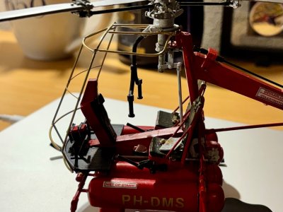

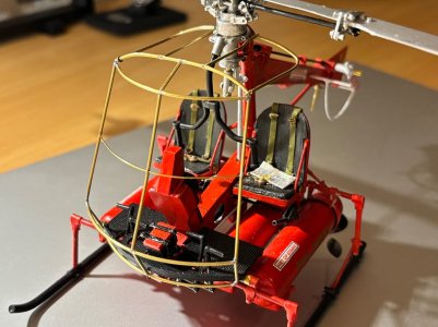

Canopy frame seen from (almost) the side, looking towards the right.
The frame is build from brass tube and bar.
View on the unfinished frame, seen from port front, looking aft.
This is great Johan! I love the detail, so many nice features you have added. You have made a model that's better than any kit...congratulations on your accomplishment!Being fed up with the fabrication and installation of flight controls, I set those aside and turned my attention towards the component I started my build with; the canopy.
Indeed Peter, lots and lots of small parts went into this model and my forming technique improved quite a bit during the last few months.That is a very nice fitted frame, Johan. A lot of small parts and bendings.
Thanks Paul. I have to mix soldering and use CA in some of the joints. So first solder using a so-called third hand and the other joint will be bonded using CA. Still, it's all a bit fragile...Impressive! How in the world did you keep the parts in place for soldering???
Thanks for your compliments. I found working with brass was a necessity; I tried polystyreen sheet and profiles, but that didn't give the required rigidity.Really impressive work with such tiny brass tube!! Thanks for sharing this wonderful build!
Thanks so much Dean. Changing the scale from 1:48 to 1:24 became the game changer: it opened up the possibility to add a lot of details. Now having added to framework of the canopy, the model definitely resembles the full scale helicopter.This is great Johan! I love the detail, so many nice features you have added. You have made a model that's better than any kit...congratulations on your accomplishment!
