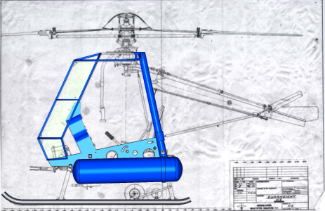

A very nasty surprise were the scans of the partly dimensioned main geometry drawings of the helicopter. The ratios of the scans in X- and Y-directions are not the same, so I had to check known dimensions in both directions to ensure correct scaling.
I'm not sure where this error originates from, is it in the scanned originals, or is it the scan software of the cellphone, or is there another phenomenon I'm not aware of?

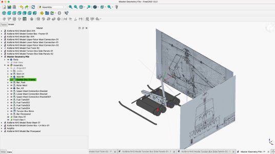

Also, the FreeCad software frequently crashes and, while there is a restore function, more often than not I end up with corrupt models, taking endless hours to repair.
The best way to split up the helicopter provides me with a nice challenge; I have to consider preliminary build sequence and manufacturing techniques, which dictate the way I have to set up the structure of the models. Since I'm building a scale model, it does not necessarily has the same structure as for its full size namesake.

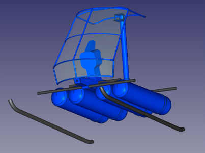

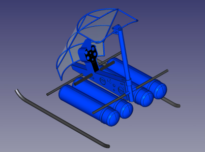

Below a picture of where I'm currently at, it's slightly more advanced than what I showed in Loracs' blog, lack of progress is mainly due to lack of progress, caused by system crashes and frequent backtracking to correct modelling errors.

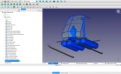

It's easy to establish that the free version of Autodesk with its limitation of ten models is not working for me. By the time I'll have the 3D-definition completed, I expect to have 50+ models and that's a conservative figure.
