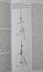

All the Caldercraft kits do not have sails, but still had a lot of running rigging and their respective blocks. When I did the Endeavour, it had heaps of both and 4 sets of plans dedicated to just the bare rigging.. I understand that the yards are in a different position when sails are not present. The only rigging missing would be that connected to the sails.
The Peterson period ship rigging book goes into detail on both
