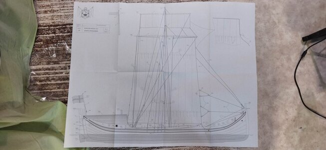

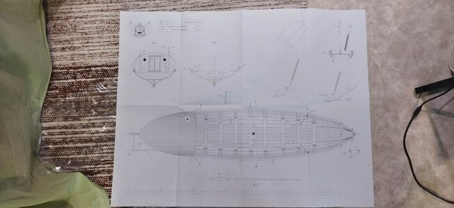

Drawings that billing boats has in the kit, Quite nice, but as it happens, i own another drawing of the same boat;

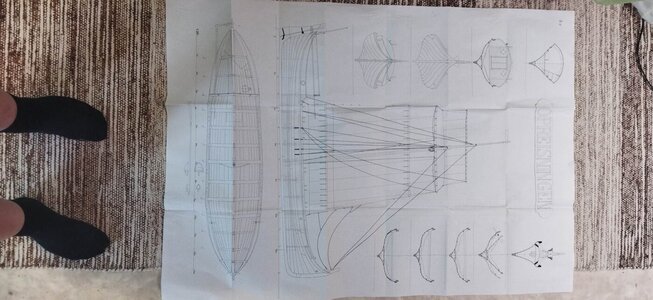

In which some of you might see some differences without even overlaying them over each other. This means i will not try to replicate Opreisningen, but i will just build a generic and nice looking boat out of it - hopefully, that is. At least i can take approximate plank join locations out of the better drawings of Opreisningen and replicate them on my model as well, i believe they will add a nice bit to realism when it is done.
There will be plenty of plank steaming and forming and drying to be done, which honestly terrifies me a little, but i will do as i always do with these kits - i will draw out the planks so that if i fudge up one or two i can easily make replacements. I also am gonna need to order a ton of tiny nails for this boat, as the nails are a prominent part of how these boats look like, and in my opinion these boats look a bit bland without them. I will also try to stain the sails the same way the originals were stained, and i will change all the white rope work to dark ropes which look like the real ones which are tarred to withstand weather better.

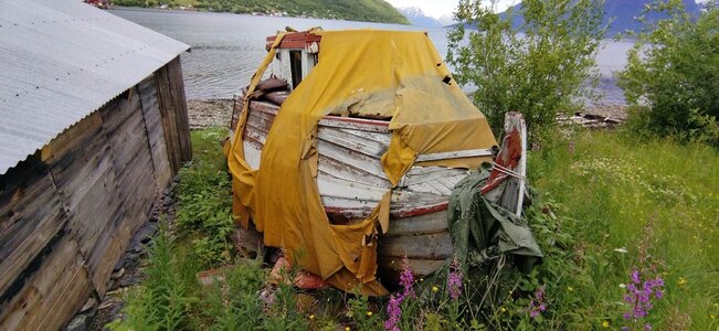

Thanks! I have a huge thing for these particular boats, i don't know why. I just want to build an armada of them! If this one is a success and somewhat tolerable to build, i will buy another kit and make it into a motored version - i found a rather interesting-looking one that was abandoned from norway on my latest trip, albeit it was a shorter version than a full blown åttring - i think it was a ''motorseksring''
